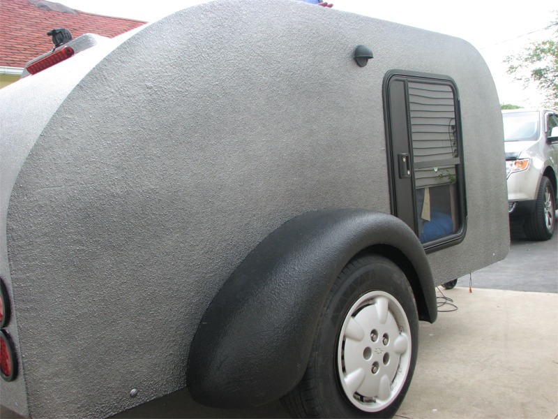

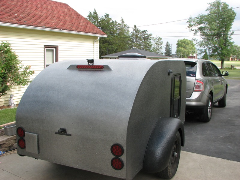

Postby DrCrash » Mon Jun 29, 2009 4:14 pm
well Rhino lining came in at 63 lbs..
Total weight of trailer is 1260 compleated..
Pics being loaded now..

Now that is hot! I really like the rhino liner on it. Please keep us updated on the liner. Sure wish they made lots of colors....... 8)
Postby DrCrash » Mon Jun 29, 2009 8:22 pm
The guys who shot the Rhino lining on it can match it to any color you have a code for. They put the paint ontop of the rhino before it cures and they say it bonds to it as if it is one then they clear coated the whole thing. I am totaly happy with the way it came out.

Interesting finish...bet it'll stand up to a lot because it's tough stuff! It might even give you a little extra insulation from the heat and cold. Your teardrop has nice lines and looks good with your car. :thumbsup:
Hey! Don't just tease us with the outside shots! How about some inside picies?! 8)
Congratulations on completing your build! :applause:
