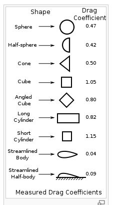

Postby Arne » Wed Dec 30, 2009 5:55 pm
ah, now if you could only get the laws of physics to agree with you...

Postby PaulC » Wed Dec 30, 2009 6:17 pm
Arne wrote:ah, now if you could only get the laws of physics to agree with you...
[/img]
Arne, get it right mate. All those coefficients are rated in a clean air situation, NOT in the dirty air behind a tow vehicle. Or the dirty air of a freeway with all types of vehicles around you disturbing the air.
