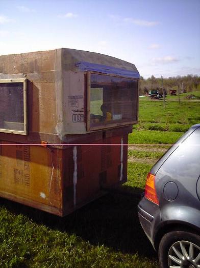

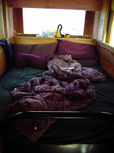

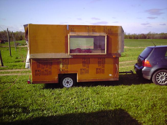

The whole extended family went to my parents blueberry farm to help with this year's planting. I could either sleep on the floor in the 70' housetrailer with a half dozen other people, or bring BUB... The choice was obvious.
I've been too busy to build a door for BUB so a HF tarp gets clamped to the roof. At night, a 3 foot tall piece of plywood gets clamped over the bottom of the doorway to keep curious critters out.
yeah it's a mess but it's a queen sized mess.
if tou look closely at the upper left and right sides of the picture you can see the 3 foot long 2 by 4s wedged in place to hold the cap up.
It got down to a breezy 38 degrees F at night, and even with only a 500 watt heater and a leaky tarp for a door, it was still comfortable sleeping weather inside.

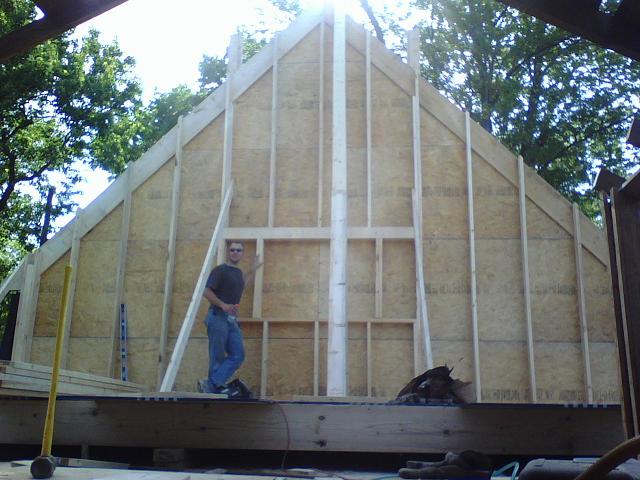

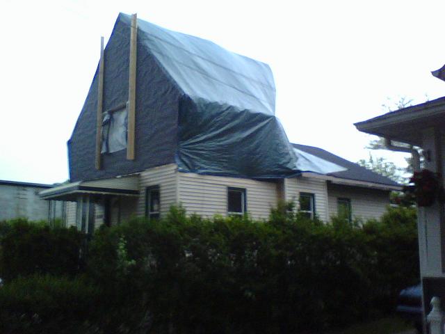

BUB is taking a back seat to this summers project. I'm adding 1,100 square feet to my house.
the right side of the picture shows my original roofline, the left half shows my new roofline.
Thats me standing under what is going to be a 17 foot cathedral ceiling.
BTW does anyone know of a football team in the greater Detroit area that i could borrow to help me raise my back wall?
