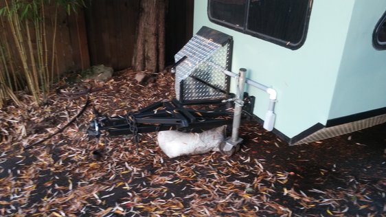

Only one of Andrew's tongue strength pages work from the Design Library under Design Resources at the top of the forum page because Andrew & his website have disappeared. For some reason the links to his original pages that I saved don't work in your thread. However, they work in this thread: viewtopic.php?f=26&t=66458&start=45 I've asked Mike to include them in the new Design Library. I'll ask again.
My concerns:
1. There is constant up & down vertical stress on tongue rails where they meet the front cross member, even on smooth road.
2. There is also horizontal stress, especially on a single rail.
3. In addition your bike rack will add a twisting stress.
4. Welding where the rails meet the front cross member sets up the likely potential for stress cracks next to the welds. If welding is needed it should be done longitudinally along the top corners of the rail as little as possible.
I recommend cutting off this tongue & starting over with an 'A' frame tongue that runs back under the chassis past the second cross member & out to the side rails. I'm willing to help determine the size & type of steel that would meet the Australian tongue strength rules. It would require getting your trailer weighed with gear aboard & deciding the tongue length.
You've expended a good deal of nice effort & money on your rig & I'd hate to see you loose it because the tongue broke.

I'm going to have to second Alaska Teardrop on this one. That tongue looks bent where you welded on the two mounted pieces. I don't know if that was pre-existing or if it was overheated from your welding. (happens easily) adding the two diagonals as you have just done does nothing to make the tongue stronger. the weakest point of a tongue, where the forces are highest is were it connects to the first cross member. or in some cases it is weakest where you add loads to the tongue, like 300 lbs of rack and motorcycle. either way, adding those existing diagonals does nothing to solve either of those concerns.
IF your tongue was not bent, adding a full A frame front second cross member to hitch under your existing tongue would be an option to provide additional support without throwing away your previous work. but because it looks pretty knarly, I would strongly consider cutting it off and building an A Frame tongue from scratch. It is quick and easy and the time and steel spent is cheap insurance against your tongue snapping or buckling and your trailer rolling off down the road while on the highway.

I'm with you guys. For what it's worth, the tongue always had those two slight bends as part of the original design. I'm going to size it up and plot a solution based on my online research soon. Thanks.

I'm about halfway done with the tongue overbuild/mods. The extra steel was $106, so that's (helpfully) a lot of extra weight on the tongue. The countertop looks bad, though, so that will take more time than I was expecting. And I stuck the last LED/USB unit on the wall.

I finished the tongue upgrade today. I started with 2x2x1/4" steel square tube. I cut and notched the top of one tube to match the bends in the existing tongue and then sistered it up under that. It extends about 18" under the trailer, stitch-welded. I also welded the existing tongue to the angle steel that the tilt mechanism used to slide into. Then I added another length of square tube alongside the new length, this time without any cuts or bends, stitch-welding that too. I added a little support for the motorcycle tray to prevent rocking/twisting. I put everything all back together with a nice self-etching primer and a couple layers of paint. I'm satisfied about the strength of the tongue, and based on my research, it should be at least 3 times as strong as necessary.

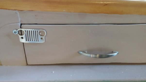

I installed the last of the cupboard handles (minus a tiny one that needs a door). I also installed these Jeep drawer stops at both ends of the drawers. Then I vacuumed the trailer, including the ceiling and walls, which were all dusty and dirty. Then I wiped the floor down and wiped up the spray from wet-sanding that had got all over everything.

Ha! Love the drawer stop! Nice!
