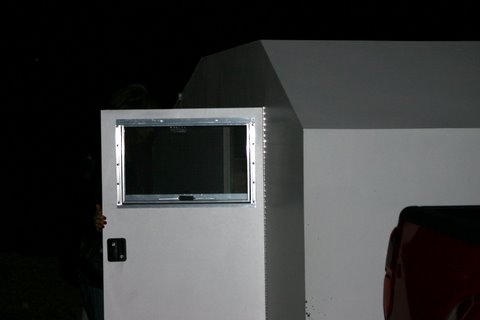

Postby Cliffmeister2000 » Sun Sep 14, 2008 11:36 pm
Getting closer! :D

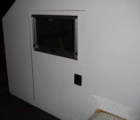

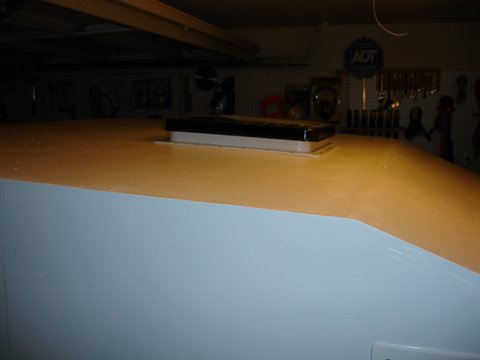

Fantastic vent on permanently
Doors on permanently, with windows and handles
Door jams on and ready for weatherstripping.
No picture, but the taillights are on and working also. Not a bad days work. I need to put the weather stripping on the doors and hatch, and put the hatch latches on, and this thing will be camp-able! Still tons to do inside, but a major milestone is just around the corner!

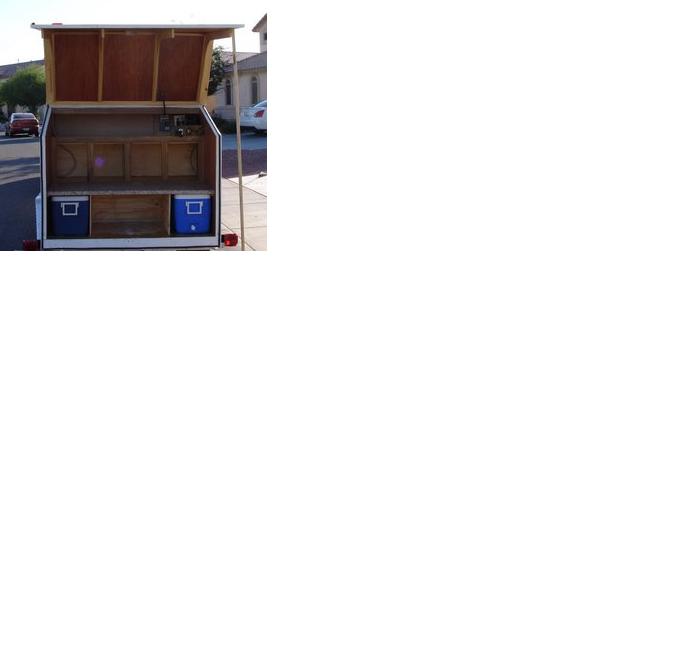

I have reached a critical point in my build. I want to install gas struts to assist in opening and keeping open the galley hatch. I don't know where to begin as far as attachment point, closed length, open length, etc. :? I opened the hatch, and supported it on a pole and put the pole on a scale. the hatch puts 32 lbs on the scale.
I don't have a great picture of the galley in its present form. :oops: This picture shows the hatch.
And this one the cabinet frames inside
Any help would be appreciated.

Postby Cliffmeister2000 » Mon Sep 29, 2008 10:08 am
here's a little better picture of the galley
