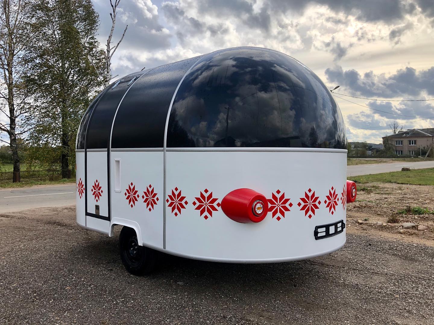

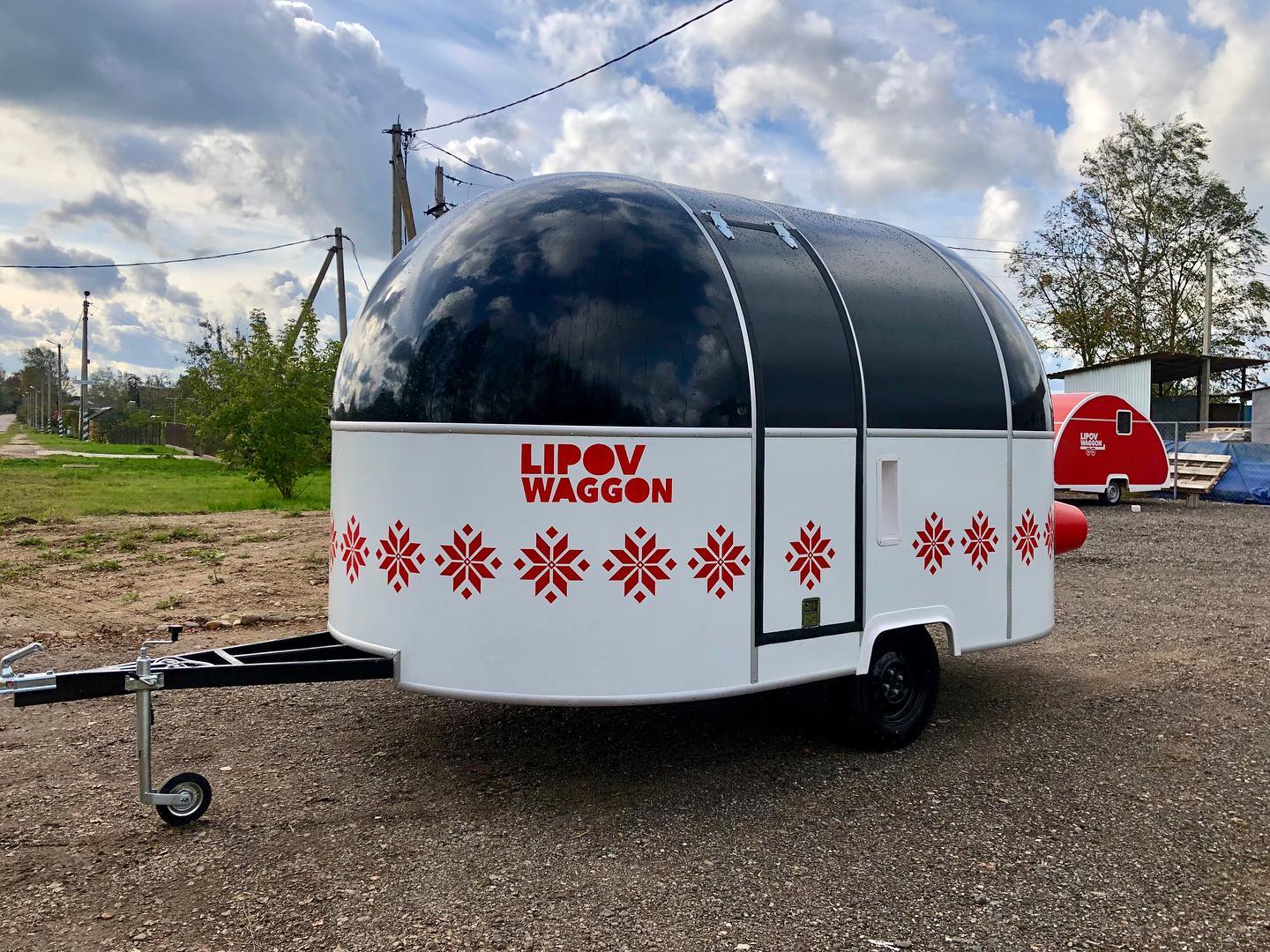

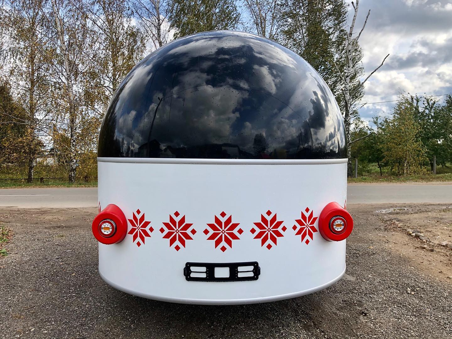

Postby flyweight » Mon Dec 21, 2020 6:00 pm
I hope this hasn't been posted before, but it's new to me. Behold the Lipov Waggon (Belarus) Food Truck
Sauce: https://www.instagram.com/p/CGhqO3KhNrU/
