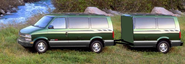

I have an Astro van I am going to use as a tow, so I am kicking around the idea of using an old astro van we have just sitting around with a blown motor to make a trailer to match my van.
here is a quick mock up I made in Paint

Postby jagular7 » Thu Feb 01, 2007 11:33 am
Gambam wrote:I have an Astro van I am going to use as a tow, so I am kicking around the idea of using an old astro van we have just sitting around with a blown motor to make a trailer to match my van.
Biggest obstacle would be weight. The weight of the frame, axle, and suspension.
Turn it around. Make the engine bay your kitchen. Box it in and seal it. The grille can swing open or split and drop for table tops. Cut in front of the rear wheel well and slice in the rear doors to that point just to keep it a 'van'. Darken the front windshield so that you can see out and get pull down 'to fit' curtains, like in the TABs, for all the windows. Use your headlights as brake lights with red bulbs. Keep the turning lights as turning though this will require some work on the tow vehicle since the turning and brake lights are on the same circuit. Take the rear axle from a front wheel drive van and use it for yours. I had thoughts of something like this for a long time but using a Dodge Caravan due to the unibody design. This keeps it light for the frame is part of the floor. Not sure if your style GM van has a separate floor and frame.
Biggest thing to configure is the weight distribution with the wheels so far back.
Here KC metro area, there is an airport taxi service that travels to the other cities around KC (ie Topeka) to pick up customers. They have a full size van pulling a chopped Caravan trailer similar to your cut.

Postby Gambam » Thu Feb 01, 2007 12:14 pm
Astro tips the scales @ 4000lbs. So loosing the whole front clip, drive tran, mufflers, gas tank, and stripping the insides of all the seats and such should drop the weight problem alot. My van has a tow cap of 5000lbs, but from what I've read I want to keep my max towing around the 3500lb mark.
The whole idea is still a pipe dream, I guess I better watch what I put in that pipe from now on.

Postby Gambam » Thu Feb 01, 2007 12:28 pm
here it is a little shorter to lighten up the hitch weight and using the front windshield to make it a little more shapely.

Postby bledsoe3 » Thu Feb 01, 2007 11:55 pm
I like the first one. You still have the sliding door and rear access. It would be heavy though.
