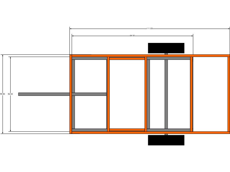

I'm still working on the platform. Now I'm thinking about using wood instead of steel to enlarge it. Like this:
I would use pressure treated wood. 2 x 4s would stick up above the 2x2 angle by 1.5 inches. I would put 1/2" ply on top and insulation below. 3/8 ply under the insulation that would be coated with roofing sealer to weatherize it.
What do you think?
The framed area in front of the axle would be a sunken storage area.
Cliff

Postby Miriam C. » Fri Sep 07, 2007 4:00 pm
Cliff it sounds like a good idea. I am not sure you need 2x's to do it though. Secondly do you need insulation under in AZ? The bed will provide a lot of insulation. Course if you are wanting to keep the road heat out.......
Postby mikeschn » Fri Sep 07, 2007 4:14 pm
Hey Cliff,
To add an extension of wood to the rear is fine. Once you have your body built, the whole thing will act like a torsion box, keeping things square, and rigid.
I wouldn't use pressure treated wood though. Just use pine or poplar, and when you treat the underside with roofing tar, it won't go anywhere in your lifetime.

Postby Cliffmeister2000 » Fri Sep 07, 2007 4:46 pm
Miriam says:
:lol: - Desert camping is hot a lot! Of course, the desert can get really cold at night too! Then there's sound...
I plan to use this thing year round, and all over the place. I bought a Samsung 5050 btu air conditioner two weeks ago at Home Depot for desert camping. Gonna get a generator capable of powering it (Honda Wisper) too, for wilderness camping. I've gotta get started! The temperature is dipping below 110 degrees now, there's no time to waste!
Mike says:
Thanks, Mike! The wheels are so far back on the existing trailer (19 inches from the rear) that adding 24 should be fine without moving the axle (which is fastened to leaf springs that have their pivot pin assemblies welded to the frame, so they would be tough to move).
Now I just have to control the urge to make it bigger, since I bought a new Nissan Frontier to tow it with (6,500 lb towing capacity). :)

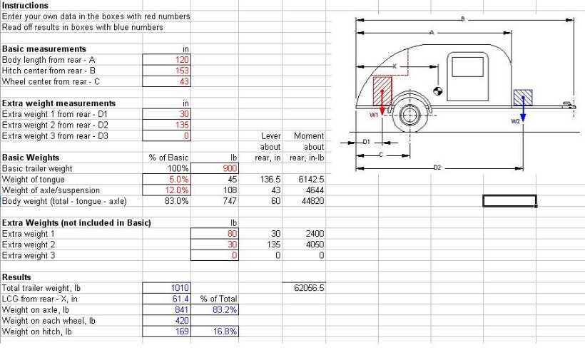

Postby Cliffmeister2000 » Sat Sep 08, 2007 7:07 pm
Mike says:
Have you run the tongue balance spreadsheet on your design yet?
Well, I ran it. Does it look okay? The tongue weight is more than 10%, which I have heard is optimal.
- Cliff

Postby mikeschn » Sat Sep 08, 2007 7:10 pm
169#. That's not that bad. Especially if you are towing it with a small truck or small sport ute.
My tongue weight on my Baja Benroy was over 350#, which caused it to porpise.
I think you'll be okay with that tongue weight. You just won't be moving the trailer by hand.
