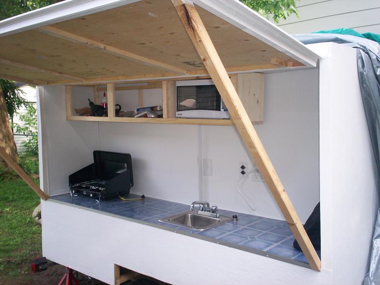

Galley (refer to go on right side):
On demand water heater mounted in camp position (stored for travel):

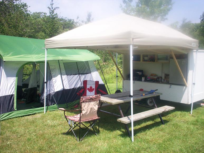

Here is the camp setup. On-board 230AH batteries/1000W inverter kept the little fridge running for 2 days. It helped that I put a case of bottled water (frozen) at the start of the trip, to minimize run time.

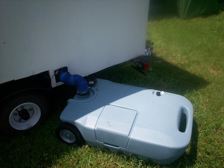

Here is the mobile waste water tank. The only on-board tank is 30gal fresh. (I really gotta trim out the wheel well area :thinking:
