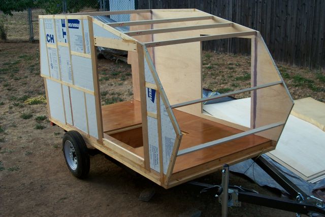

Today I worked on cutting and dryfitting some of the stringers. The sides are not epoxied in place yet; I've got to figure out how the galley wall is going to fit in there first and also I've got to finish the inside walls. I think I'm going to paint the inside walls, leaving the wood floor and footwell as they are and I might do some sort of headliner for the ceiling (not sure yet) sort of 'design-as-you-go' here
I'm thinking a small fixed window might be nice in the front also :thinking:

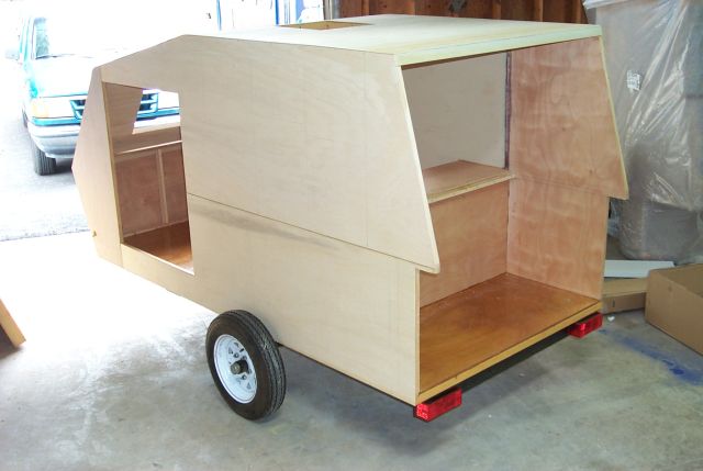

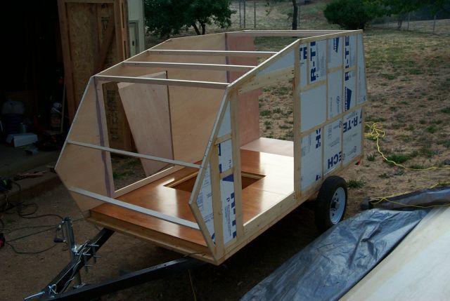

Postby rmclarke » Thu Sep 18, 2008 1:31 am
Wow, two months goes by in a hurry :shock: I thought I was going to have this thing 'campable' by October :laughing1:

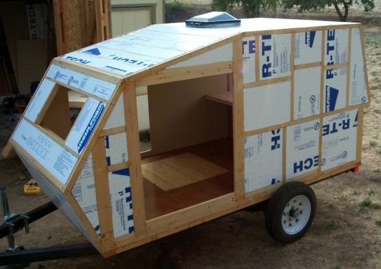

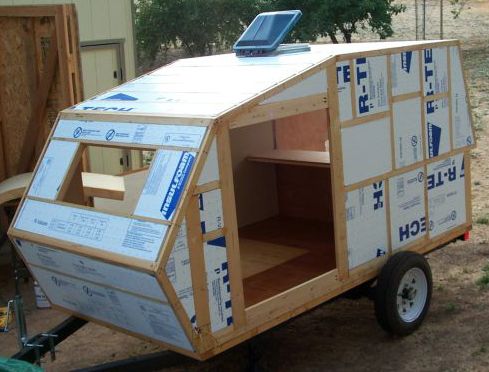

But I am making some progress, walls are epoxied into place, so is lower galley wall.
I added extra stringers to the roof and the whole thing is now insulated (roof and front with 1 1/2" foam, walls with 3/4")
There's just sooo much stuff to do!! :? :shock: :o it seems like I'm becoming distracted more easily...I start on one thing, and soon I'm doing something else....just trying to stay focused is a real challenge! :NC

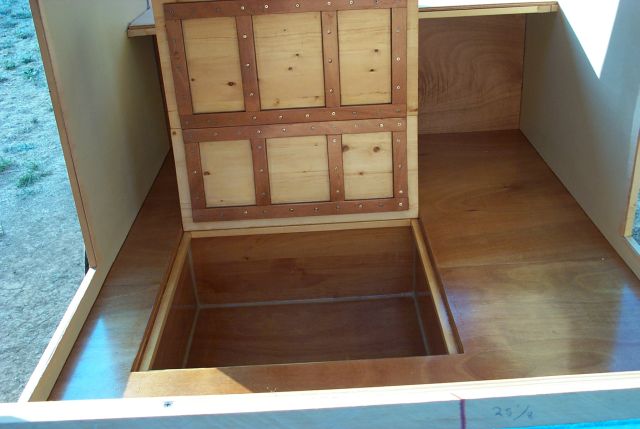

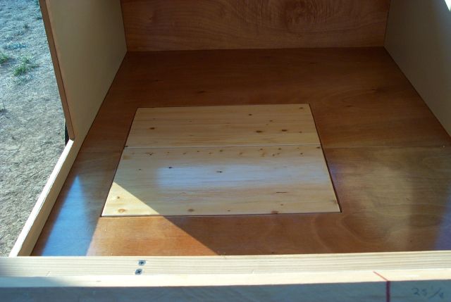

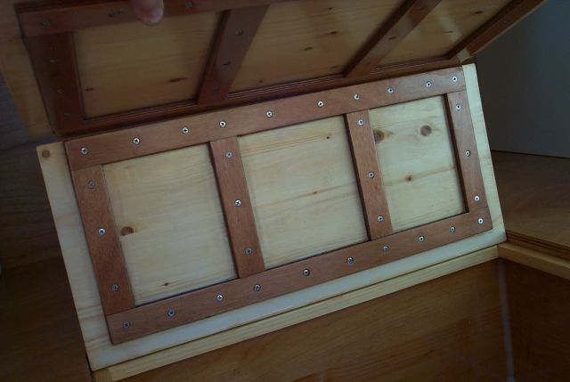

Still working on the folding table over the foot well. I don't have the hinges yet or the table support; I cut strips of okume ply to support the bottom of the laminated pine table and epoxied and screwed them into place....seems quite strong. (I just propped it up for a few pics):
Forward interior headboard support (not finished with it yet, I'll post more pics of it later)

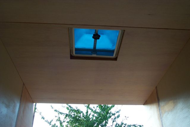

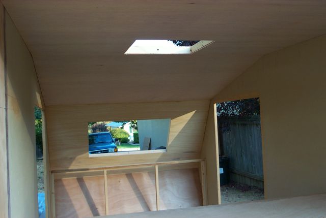

I'm just going with an overhead vent. I think it will work fine for us. No air conditioning...we do a lot of camping on the Oregon coast. Will probably need a heater before we need AC. I found a neat gray smoked colored vent that has angles instead of rounded edges....I think it fits well with the lines of the Sunhopper. Also, my windows are going to be smoked plexi.
Today, I started cutting the exterior side panels. Hope I can post some more before another 2 months goes by :)

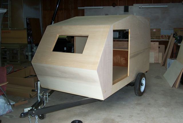

Postby rmclarke » Wed Oct 15, 2008 4:40 pm

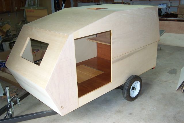

Exterior skin is on :D :D
Next comes filling a 'million' tiny nail holes with epoxy :( ....wish I would have 'eased off' on that nail gun now!!
