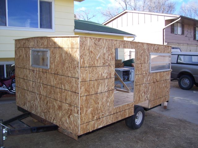

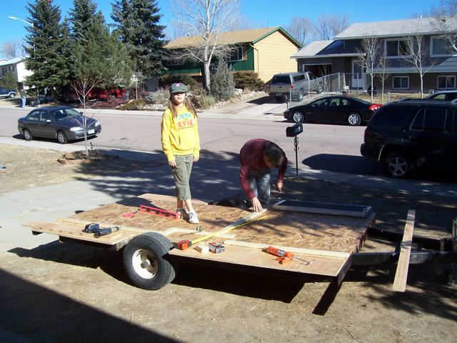

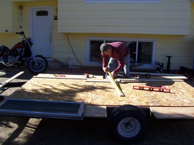

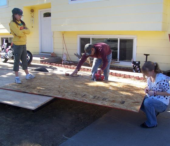

I got both side walls built today. Weather was 58, not bad for January. First wall took about 4 hours, second wall one hour. I decided to go with OSB, I'll get some aluminum from work to sheet it. Debating on the floor. I want indoor/outdoor carpet. Steph want vinyl flooring. I bet we'll end up going with vinyl flooring. The kids came out long enough to get their pictures taken, Steph came out long enough to take pictures. I told them they will be camping in tents if they don't help. I'm hoping to get the front wall built tomorrow and the three walls up, possibly even put the roof supports/trusses in.

Myke wrote:I got both side walls built today. Weather was 58, not bad for January. First wall took about 4 hours, second wall one hour. I decided to go with OSB, I'll get some aluminum from work to sheet it. Debating on the floor. I want indoor/outdoor carpet. Steph want vinyl flooring. I bet we'll end up going with vinyl flooring. The kids came out long enough to get their pictures taken, Steph came out long enough to take pictures. I told them they will be camping in tents if they don't help. I'm hoping to get the front wall built tomorrow and the three walls up, possibly even put the roof supports/trusses in. I'm trying to load pictures but I keep getting file to large or corrupted. I cropped them to 640x480. I'll keep trying.

Myke, you may have to lower the resolution for them to be uploadable. They may be 230dpi out of the camera and you should lower them to 96or so dpi.

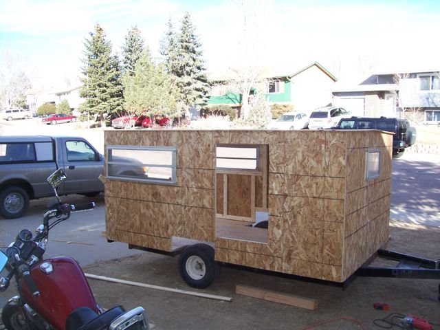

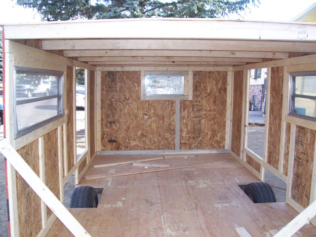

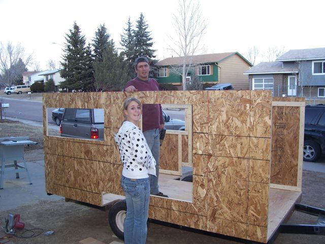

Got the roof and front wall done today. I also did the wheel wells after taking pictures. No help from the tenters at all today. They think I'm joking, but it seems to me if they don't want to help, first night camping they ought to be in the tent. Of course I live with 3 women, so that will be shot down.

This looks like a great build! I like the slight, almost missed it, slope. In the pictures, the trailer looks really big and roomy! :thumbsup:
