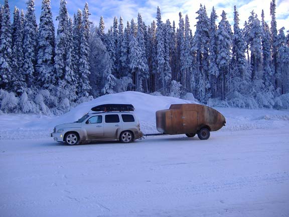

I left Alaska on December 27. I pulled the vary overloaded trailer with a front wheel drive HHR. That was interesting, it was -35 F on the trip back, I was glad I had installed electric breaks on the trailer. I temporarily closed up the trailer and installed some metal finders just for the trip down. No worries
