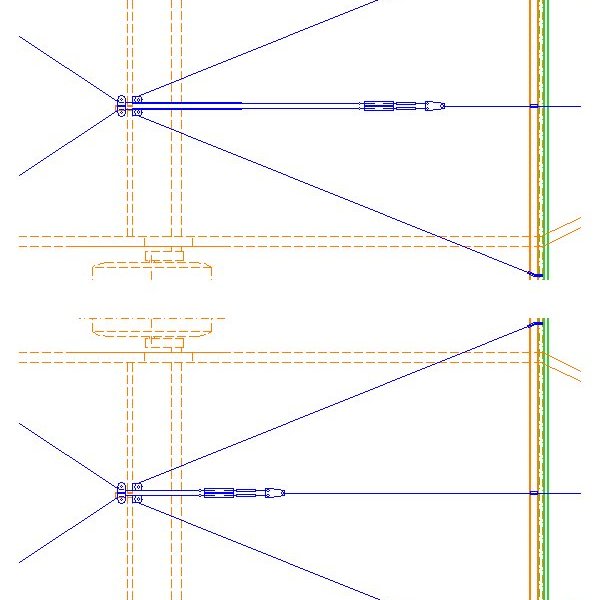

So here they are. This is the overall layout with the lifting gear in blue:
A boat trailer winch mounted above the tongue pulls on a single wire. Under the body this is split into four wires with adjusters. The wires are routed via pulleys to the four corners, where they pass over more pulleys to go upwards. On the top of the fixed sidewalls are more pulleys (total 13!) that turn the wire down to attach to the bottom of the lifting sidewalls.
The first turning pulleys need to be well back from the front of the body to leave space for the wires to be joined together and for the joints to move without hitting a pulley:
The top drawing shows the wire joints/adjusters with the lifting top up and the bottom drawing shows them when the top is down.

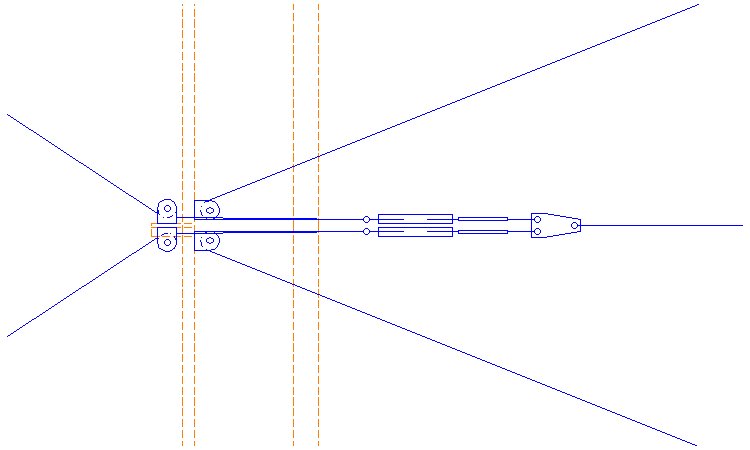

The detail of the wire joints and adjusters is shown below:
From right to left:
- A triangular plate is used to split the single lift wire into two.
- Two more triangular plates spilt these two wires into four.
- Each individual lift wire has a turnbuckle to adjust its length.
All these drawings are in my personal gallery.

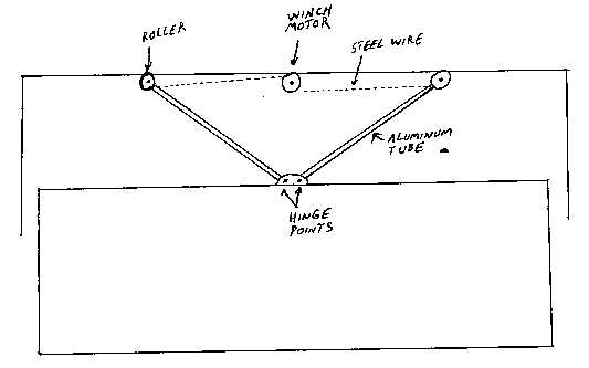

The thought of 13 pulleys having to work perfectly after bouncing down the freeway for a couple of hours, or I don't get to sleep in my camper tonight, terrifies me.
:shock:
I'm considering using the following mechanism on my popup
this is a side view showing my winch motor mounted in the canopy, pulling lift rods from an almost horizontal position, to an almost vertical position.
there would be one pair of aluminum lift rods on each side of the trailer.
the winch drum would span the entire width of the canopy, so a single winch could pull all four steel wires equally, without using any pulleys.
8)
