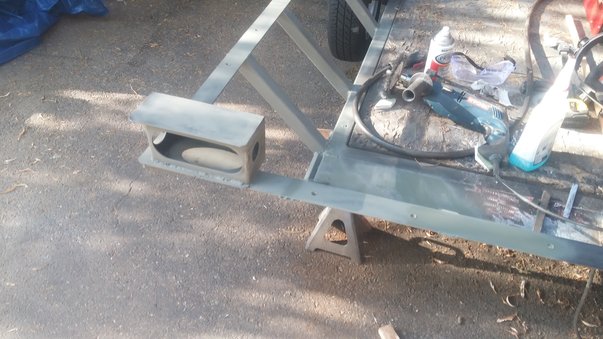

I really didn't feel like it, so I used beer to bribe myself out for a couple of hours again tonight. I welded, smoothed, cleaned, primed, and painted. The trailer now has a solid tow point that sticks out beyond where the diamond plate will be. I decided not to integrate rear leveling jacks/supports for now, and I'll probably just use a bottle jack or something. There are lift points everywhere back there, and I really didn't want to clutter up the area that will potentially get a lot of contact with rocks and, when I'm backing up, all kinds of other crap that I have a history of backing trailers into (e.g., my garage. twice.). I also re-welded the brake lights on, this time much higher and out of the way on the corners. I'll need to drive bolts right through the enclosures to support the wall studs, but I think there's plenty of room. And the walls will have a funny shape now.
I think I'm about an hour away from finishing the chassis. Then I can cut out all of the diamond plate. After that, It's really time for the lug nuts to arrive so I can use the trailer to carry a vast quantity of cash to the big box store. The dude in the brown truck and the dude in the white truck came today, but neither thought to bring the lug nuts. It's going to rain here for a few days, but I don't know how I'm going to roll the trailer into the garage with one trailer wheel and one threadlocked hub. Maybe I'll use the tiny rolling jack. That should be entertaining.

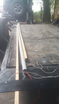

I did some trailer supply shopping and work today. I bought all sorts of building materials. I also diagnosed a faulty brake light that'll need to be replaced.
I dug out some old plasticky conduit that happens to be just under 1.5", the thickness of the insulation. So I ran some wiring through that from the front of the trailer where the battery box will be to the galley. And then I sandwiched the conduit between 1.5" furring strips that I had laying around. I also ran some wiring to the area that will hold the furnace and other equipment and to each side where bed-side LED lights will be. The idea was to run the wiring enough that I can build the floor. Additional wiring can be pulled through the conduit later.

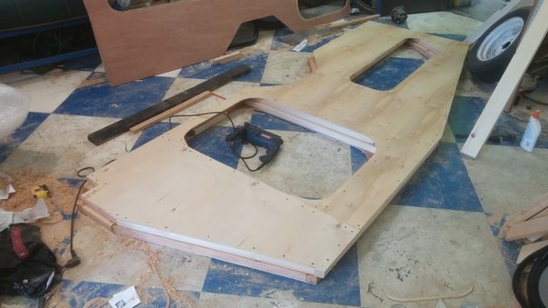

Postby artquixotic » Sun Jul 17, 2016 7:16 pm

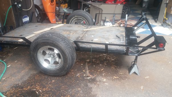

Most of the floor is in now. I don't want to finalize it because once I start on a can of expanding foam, I need to use it all. So I've started on the walls too. I clamped all four wall skins together and started drawing the cuts. Unfortunately, the mock-up of the shape of the wheel well (on drywall!) shown in the photo isn't to my liking. It's fortunate that I did the mock-up before cutting.

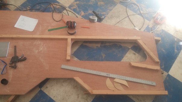

Postby artquixotic » Tue Jul 19, 2016 7:51 pm

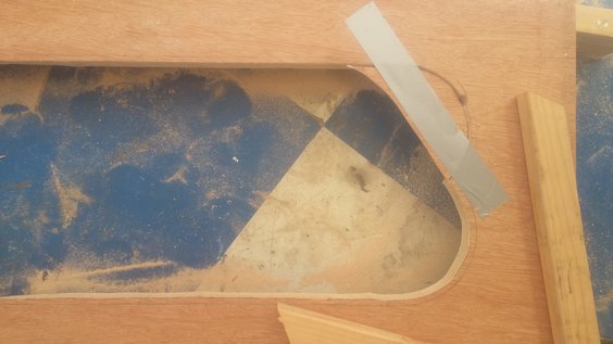

I'm not very excited about how things went today. I started out by cutting all four wall skins, including cutting around the new window. Then I cleaned all the old goo off the windows. There were at least five different types of sealant. While doing that, I realized that the windows have tops and bottoms, and that I had cut the holes upside-down. On all four skins. Having given the last of my f##cks shortly before starting on the trailer, I decided to just expand the holes and try to patch it later.

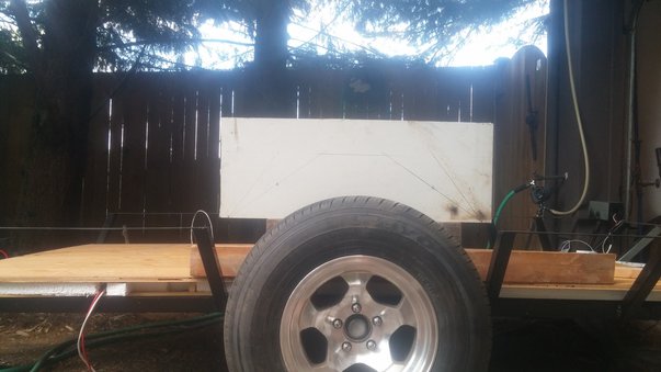

So then I ripped a bunch of 2x4s in half and started cutting the framing. The lack of doors is an impediment because I'd like to continue some supports in that direction. Plus I was making more stupid mistakes. So I quit early. Next time I can start on the inner fenders - it's going to be a headache digging the stainless steel sheets out from behind my shelves and then trying to work with it.
I'm guessing that, having to choose, I should choose longer horizontal wall supports over vertical supports - the continuousness might give the box more rigidity? That's assuming the duct tape shown in the photo won't be enough. And how could it not be?

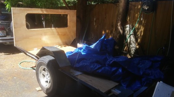

Postby artquixotic » Wed Jul 20, 2016 9:04 pm

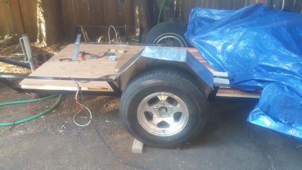

I dug out that sheet of stainless steel today and made an inner fender. It looks deflated in the photo, but that's just because I jammed it in there for the pic.
I was pretty stoked how easily it came together. It's pretty sturdy too, despite my putting it together with rivets instead of welds. I'm interested in finding some seam sealer or something that will stick well to both waterproof the fenders and keep them rigid.

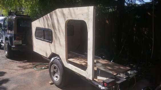

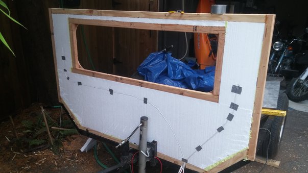

I've had some more time free from my now non-paying job, so I've made some progress on the trailer. The front wall and the two sides are almost done, and the front wall is mounted on the chassis.
The framing of the side walls was pretty complicated, so I framed one and then cut and stacked the framing pieces for the second wall on top of the finished wall. That allowed me to get everything shaped up and covered in glue before I laid the outer skin on top and glued it all together. That saved some time.
Once I had all of the walls finished and insulated, I spray-foamed all of the gaps.
Unfortunately, I ran out of screws, emptied two large bottles of wood glue, and gashed open my thumb, dripping blood all over. So progress was cut short. Maybe tomorrow I can get the sides finished and mounted up.
Oh crap. I just remembered that I forgot to install wiring in the walls for the lights. Brilliant. So there's that to figure out now.

Postby artquixotic » Sat Jul 30, 2016 10:15 pm
I managed to put in a lot of time today despite my left thumb being pretty useless. I started by running 12v wiring through the front wall before I had skinned it. There will be little LED sconces up there. I don't know if they're permanent.
Things were going fine until I realized that I had made both side walls 5" too long. That was really stupid, but, as I wrote before, I'm here for your entertainment. The bloopers continue. I planned to extend the frame out a little, but then decided to cut the 5" out of the walls. The lost rigidity is a bummer, but at least it's at the spot where the kitchen counter and storage will be adding extra support. For the second wall, I cut the outer skin in one place and will cut the wall in another place, so the overlap should add a little strength.
I cut some corners for the front window with a jigsaw and then used the Dremel to widen out the opening a little. I then put that window in with lots of black silicone. I'm not totally sure it'll be waterproof. The water paranoia has begun.
So then I put the left wall on - at least all but the back 10" or so. I used a ton of glue and then drove some deck screws way in, pulling it nice and tight. The steel frame and wall didn't line up very well. There was a gap of maybe 5/8" in one spot. If I could do it over, I'd make a much fancier jig for the frame side supports to make sure they were all more precise. Anyway, the bolts going up from the frame side supports into the wall closed that gap well. Needless to say, I used plenty of glue. Everything seemed very solid, and I still had 1/2 tube of silicone, so I decided to test my luck with the left side window. That one fit fine on the outside, but I had to widen the inside opening a bit with the old Dremel again. After the second test fit, I took it off and siliconed the hell out of it. I hope I do a better job cleaning up the silicone than I did with the kitchen sink in my house.
