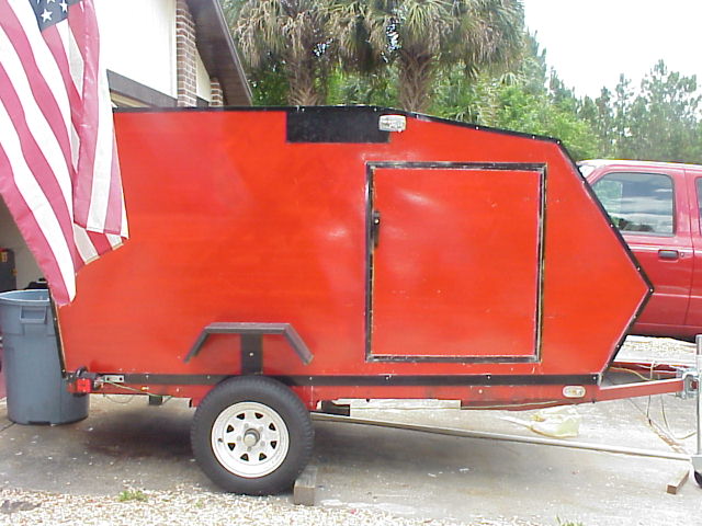

Okay I understand... so you're saying the color will be something like this...
Postby BufordT » Sun Aug 15, 2004 7:29 am
mikeschn wrote:Okay I understand... so you're saying the color will be something like this...
What a beautiful tear!!!!!
See, beauty is in the eye of the beerholder!!!!!!!!
Bufordt :twisted: :twisted:

Postby RC » Sun Aug 15, 2004 6:11 pm
Yep, only redder :!: :lol:
