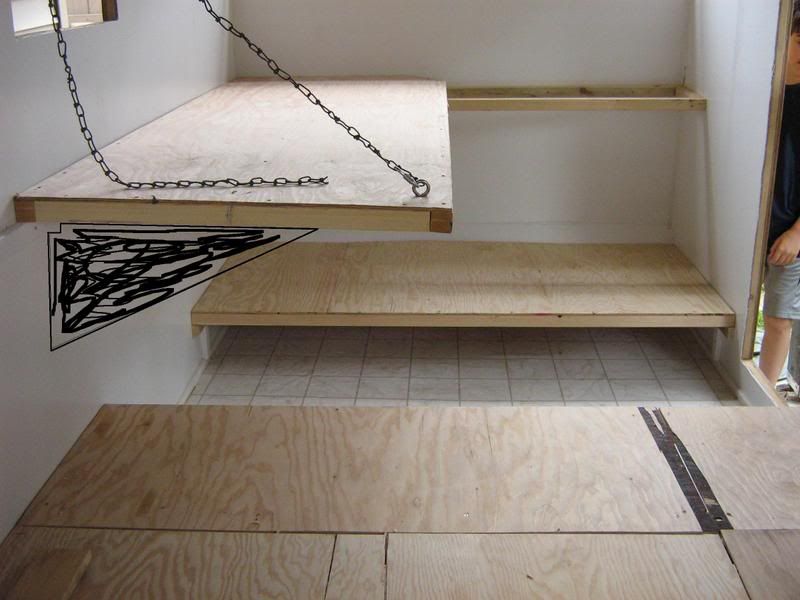

I need help with my bunks, im lookign at building something very similar to yours , but ii need the top bunk to be able to hold the weight of a grown man, i would imagine that chain would pull right out if ya had some real weight on there, i need a way to support the bunks over the master bed without 2x4s hanging all over hte place, any suggestions?

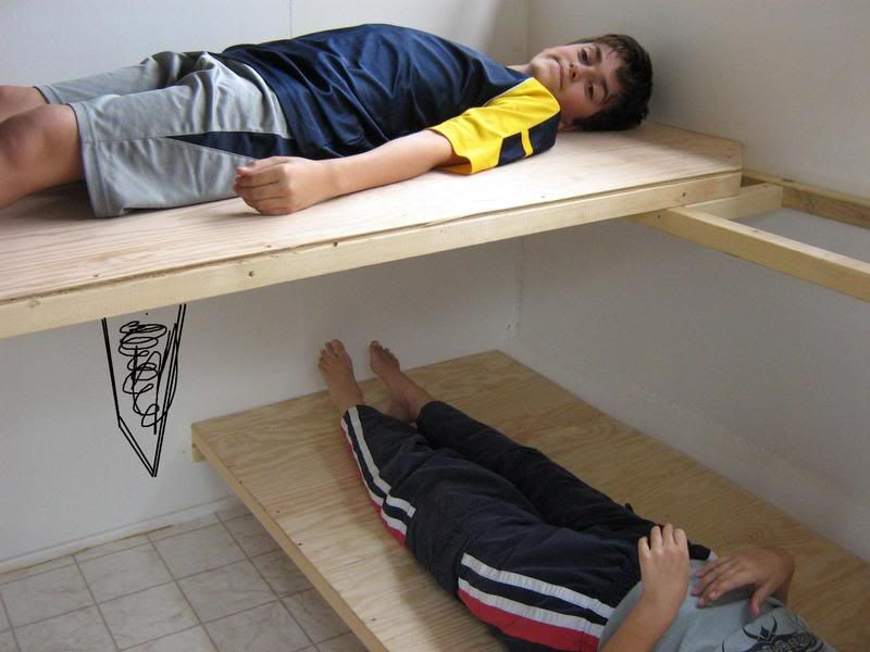

As for the bunk I used a single 2X4 as a roof rafter, there is an eye bolt in the 2X4 but not directly above the bed ( i moved it from where it was in the pic) I actually put it about 3 inches inside the wall, that way the chain will hang on an angle and not pull on middle flexy point of the 2X4, the 2X4 is supported at the end by the wall itself, inturn the eyebolt is pushing more or less directly on the wall. The front of the bed is supported by a 2X2 frame work that is screwed into the front stringers. My wife was up on the bed 150 ish pounds and the bed didn't seem to move too much. One thing I would do if an adult was to sleep in the bunk would be to augment the bunk with a swing out leg that attached to the wall.. Does that make sense? If you did that you'd be surprised at how stable the bed would be.
So basically the entire back of the bed is supported by a stringer and a hinge along the wall, the front of the bed is supported by the 2X2 structure, the rear of the bed is supported by the chain.. and add a swinging arm.. Plenty of support....
Again sorry for the crappy art work...
a pic of the shape I was planning, and then a pic of the aprx location. The leg would be on a hinge so as to get it out of the way during the day.

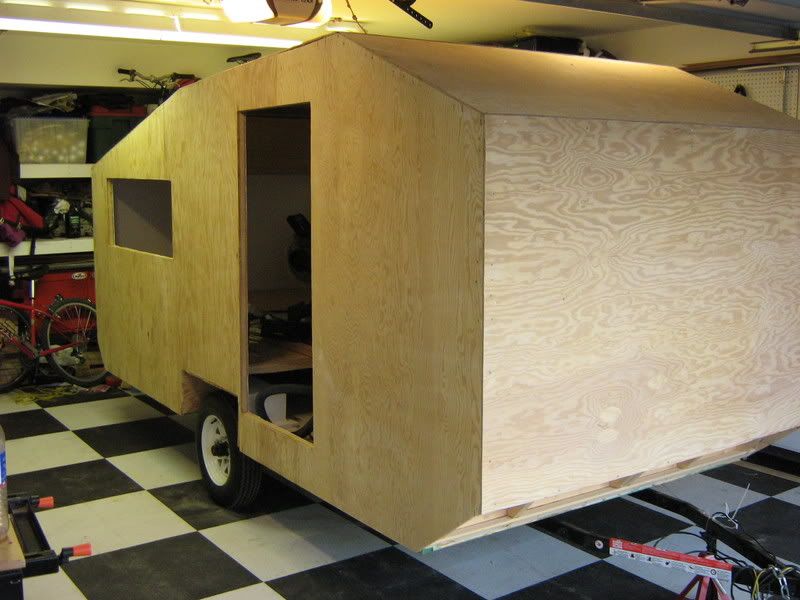

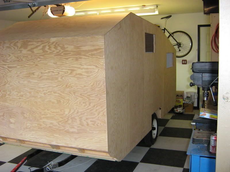

Postby beevel » Sat Aug 11, 2007 7:46 pm
Well I still haven't had a chance to epoxy the trailer, but I am done with construction. I finished the door today, still have to weather strip it but it's built, hung and the door lock locks.
Tomorrow, hopefully I'll be doing the sealing. I'm going to try to do it all in one day, gap fill, cover joints with fiberglass tape and roll one 2 coats of epoxy... long long long day.
Oh well here are 2 pics of where it stands now. Next pics will be of a completed trailer.
Oh and the trailer is definetly balanced with the majority of its weight to ther front. So despite the fact that the wheels are in the center of the trailer I don't forsee any sway problems.
