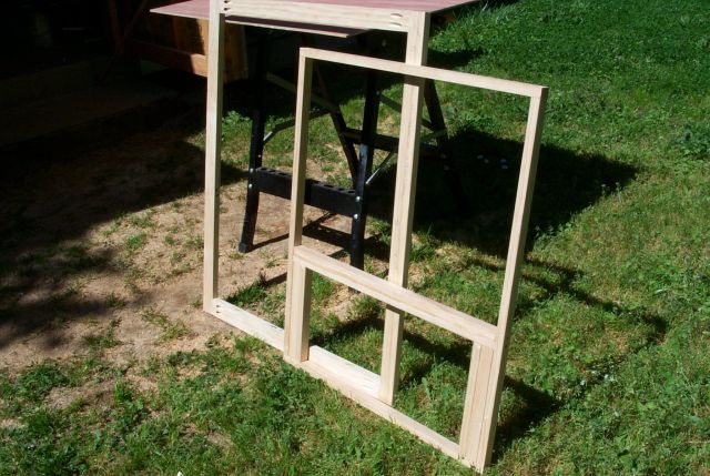

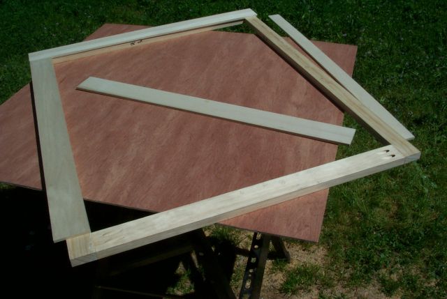

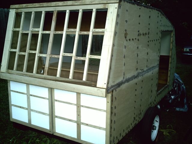

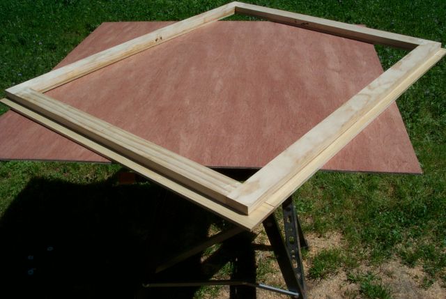

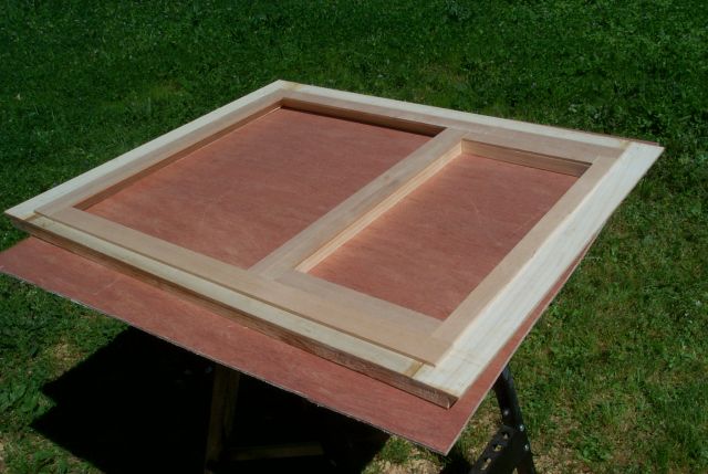

Here is a series of pics of the doors I'm doing....poplar face epoxied to clear pine frames....there will be a non- opening plexiglass window on top and a vent below it...
Inner and outer frames....doors will be inch thick...
Poplar strips to be epoxied to outer frame...
Overhanging face will close against the trailer side...
Inner frame with trim to be epoxied into outer frame; whole door to be epoxied....
Well, all for now.......but it's good to be doing something again! :)

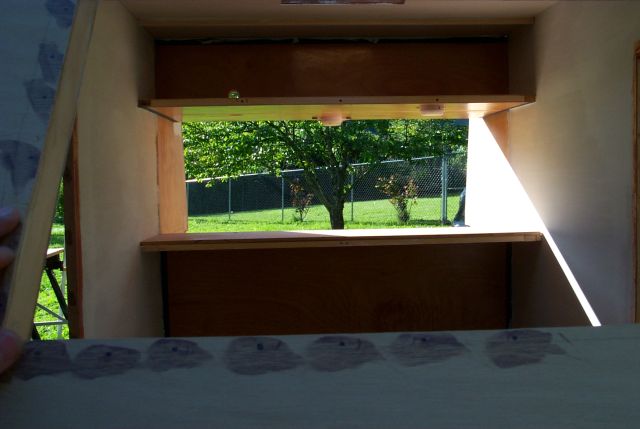

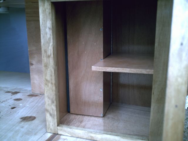

Postby rmclarke » Sat May 09, 2009 1:59 am

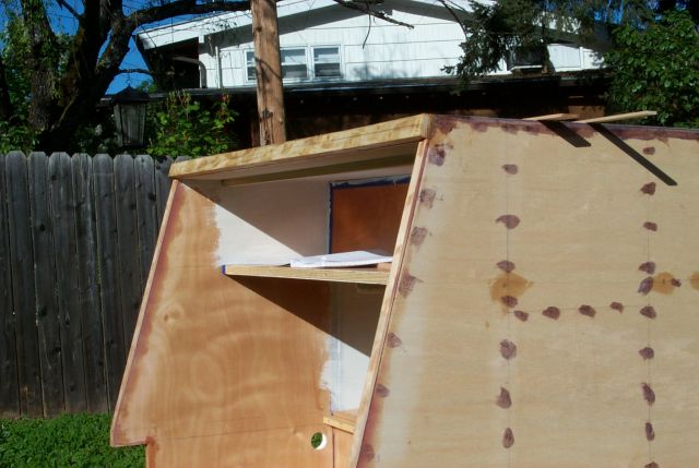

It is so nice having the trailer home again...I think I've done more in the last few days than I have in the past six months.....I've got all the nail holes filled ...edges and seams filled with epoxy....Thursday and Friday I installed the upper galley shelf and divider, hatch hinge support, drilled the hole for my AC inlet, and primer/sealed the interior....

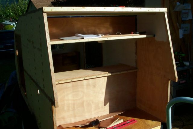

here's a shot of the upper shelf through the front window....the shelf and divider are sandwich construction 3/4 stick between 1/8 plys with insulation inside to give them rigidity...I prebuilt/varnished them ...they are screwed and epoxied into place.....I'm using two 9 watt florescent puck lights for galley and cabin side (along with some incandescent rope light later)
the trim on the headboard creates a small lip so stuff won't fall off..and the same on the 'cubby holes'
Tomorrow I'm going to try and finish up the doors and maybe do some of the dreaded sanding, so that I can finally start epoxying the exterior!

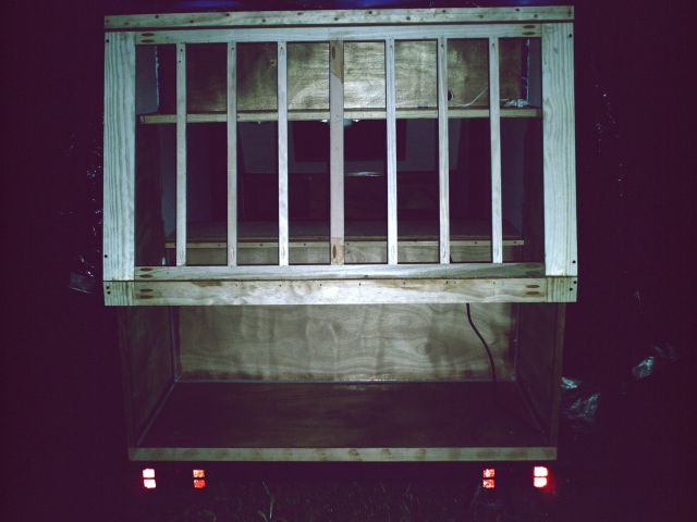

Postby rmclarke » Tue May 19, 2009 12:44 am

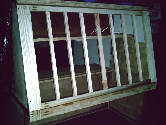

I got a start on my hatch today..... I figured the easiest way to do it was to build it in place ...so after rabbeting some side pieces, I screwed them in position and started on the cross members.
put in the verticals and hopefully tomorrow I'll make some cross supports. I filled in the gap between the bottom two horizontal pieces with epoxy glue. I'll skin the hatch inside and out with 1/8 ply and put foam insulation in it.
Sorry about the dark pics.....night was falling when I tore myself away from it..

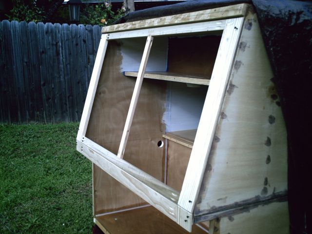

Postby rmclarke » Mon May 25, 2009 12:24 am
Weather got cold and rainy for a few days here, so I worked on other things. But today, I put cross bracing on the hatch and fit and measured the two lower doors.
Figuring out how these 3 back doors will fit together (allowing for clearances and stuff) and how to weatherstrip them is becoming a major time-consuming pain in the keester! sometimes now, I wish i would have simplified a lot of the stuff which seemed so easy while I was playing around with it in SketchUp... :scratchthinking:
It's like Clint Eastwood said in one of the 'Dirty Harry' movies......"a man's got to know his limitations".....oh well, too late to stop now

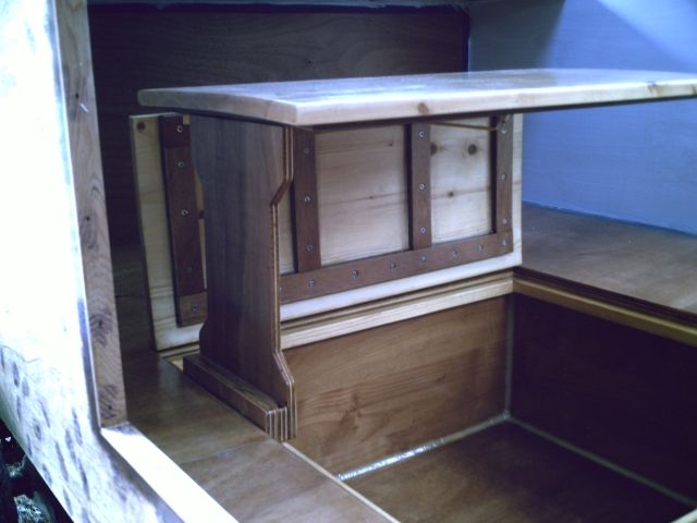

Postby rmclarke » Sat Jul 11, 2009 11:31 pm

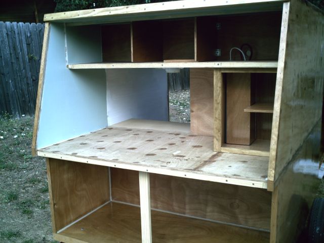

Today I figured out how to get rid of every flying gnat and insect in the neighborhood..........I finished applying my second coat of epoxy to the outside of my trailer and they all tried to commit suicide in the wet stuff!! :? :shock: :o :roll: ....it's a good thing I'll be sanding again oh joy before I prime and paint.
(Sorry the picture quality is a little cheezy....had to use the cheap camera, the nicer one broke...but hey, a pic is a pic right?)

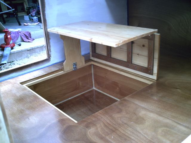

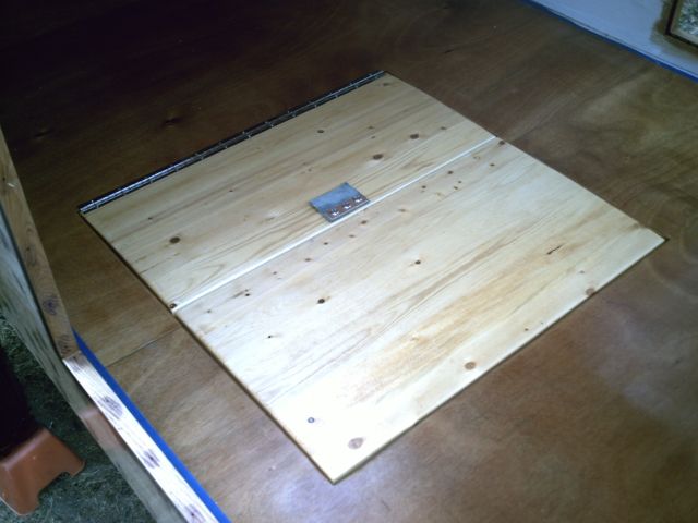

I also finished my dropped floor/table today......seems quite sturdy even though it's only supported from one side...I didn't want a support on the other side because we will be sitting in an "L" shaped arrangement...

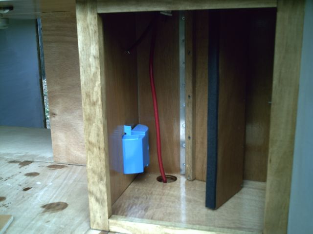

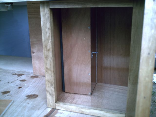

The galley counter is in....I'm thinking of thin glass tiles for the surface....lower right hand galley cabinet is also the home of my electrical raceway....
Looks like a good place for coffee mugs and stuff..
When I do need access to it, the floating shelf will just pop out and it opens on a hinge...
My electric stuff is going to be very simple...incoming AC to GFCI to circuit breaker protected power strip under galley counter to another power strip overhead..

Postby High Desert » Sun Jul 12, 2009 12:16 am
I really like your table idea Richard, thats slick! :thumbsup:
Keep up the good work, it's coming along nicely :applause:

Postby schaney » Tue Jul 14, 2009 5:52 pm
I agree with Shaun, that's a clever table design.
Scott
