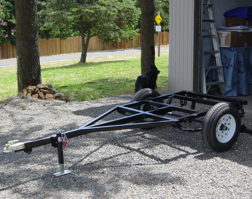

Postby schaney » Sat Jun 20, 2009 9:55 am
Finished assembling and painting the frame.
Here is how the shocks are setup.
I'm tried of replacing damaged rear stabilizer jack so I made them removable on this trailer. The receiver tubes will also be used for a kayak rack.

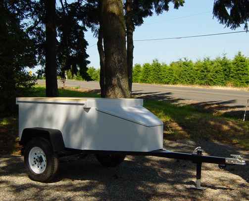

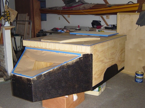

Postby schaney » Sat Jun 27, 2009 9:17 am
As I mentioned earlier I’m painting this trailer, light gray with black fenders, in Durabak, a polyurethane bed liner material. It comes in a textured with ground rubber in it and smooth that has an orange peel texture. The textured holds up well to things being kicked up by the tires. One thing I like about Durabak is the textured natural of its finish is good at covering up surface imperfections.
First I did the textured areas, this is the black areas in the first few pictures. Then went over everything with a couple of coats of smooth. This actual gives the trailer three different textures; the fenders/fender openings are the heaviest with only textured, the front/lower edge of the sides is textured with smooth over it and the remainder of the trailer is smooth.

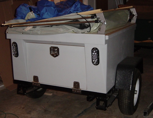

Postby schaney » Tue Jun 30, 2009 9:10 am
Got the trailer box mounted up on the frame and the fenders mounted.

Postby schaney » Wed Jul 08, 2009 10:42 am
Here is the tailgate, I made it by gluing two pieces of 1/2" Baltic Birch together. I’m using a locking t-handle latch. The hinge on the left is the one I originally planned to use, but switched to the stainless steel “gate” hinge on the right due to clearance issues when opened. I’m also thinking about switching to a concealed piano hinge for a cleaner look and increased secure.

Postby Endo » Wed Jul 08, 2009 8:57 pm
I figured it had to be from a 4x4/Jeep site. Thanks for the link.
What is the length of the leaf spring set-up (from hanger to shackle)??
Distance from frame to the bottom of the leaf spring?
At some point I want to upgrade the spring set-up on my current build. Maybe the set-up you are using would work for me as well.

Postby schaney » Thu Jul 09, 2009 9:46 am
Endo, lenght is 45", with the axle on top of the springs, it's 4" from frame bottom to the top of the axle. There is +/- 1" depending on a 2K or 3.5K axle and which of the leafs in the pack you using. If I mix in OME extra leafs into the mix there is even more height/weight carrying adjustability.

Postby schaney » Thu Jul 09, 2009 7:06 pm
Endo, no problem, here is some other dimension info about the spring pack that might be useful. The full pack with 6 leafs was 5 1/4" tall and compressed about a 1/2" per 175 lbs put on it. With only the first 3 leafs, they're 4" tall and compress about 3/4" per 175 lbs put on it. I'm initially running them with the first 3 leafs for a 1000-1100 GVW.
