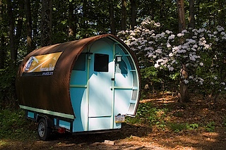

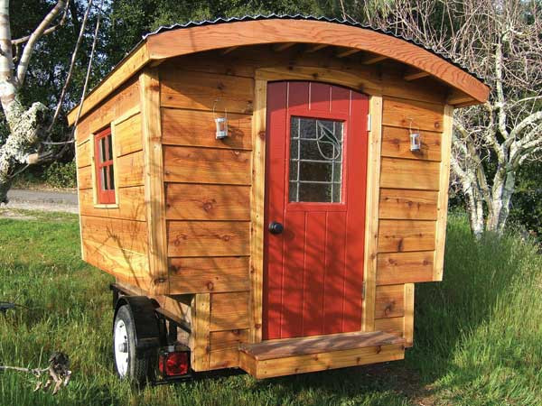

I was wanting to use shingles I was thinking of glueing them down and then coating them in a sealer so that it would be essentially just one piece of textured roof I was thinking of going with a metal foor so we'll see what happens when it comes to that time...but from all the pictures I have been looking at what is on the sides I want for the roof
Image &Image
then do a cedar lap siding so that it would also add to the front and back forces while traveling to help prevent twisting and if it is sealed properly then it should hold really good from what people have been telling me anyways and for my sides I'm still deciding I might even go with some nice and light tongue and groove pine would be easy to put a coat of fiberglass on it

Love the houseboats. Just remember that less than 3" in 12" run snow will back up under the shingles any where it can so seal it well.
Also they do make a "shingle" look in the metal roofing's...

These days you can get cedar shake siding in panels. That would give you the stability and cohesiveness you want.
