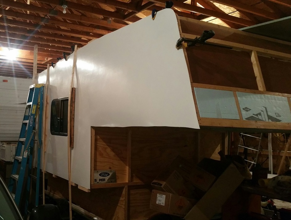

Postby mp43sniper » Thu Sep 14, 2017 10:22 am
Well it only took me 4 months, but here goes.
I removed the FRP from the sides of the truck camper last Saturday. It was hard to take off because I was really excited about that being a relatively inexpensive solution to my siding issue that had me held up for a long time and there were a ton of hours that went into it. I wanted something nice that I could install myself and not cost a fortune. But as soon as the panels were on I knew I had made a mistake. There were way too many opportunities for leaks, I had no idea what to do with the seams, and I hated the way it looked with the necessary screws all over the place. After looking around I found the fiberglass siding sold by the foot. That was ordered back in the spring but I didn't even open it up until now!
The other day I decided I actually did want to finish this project before I retired (only 25 more years to go) so I opened it up and laid the 3 pieces out in the sun to flatten out. Then all the FRP was removed and we discovered there was no way to hold up the fiberglass and trace the shape (even the individual pieces were way too heavy). I laid the FRP panels on the fiberglass and drew around them with room to finish cut later. So now we have both sides roughed out and up on the camper.
The right side has been glued from the window back and I'm hoping to have it completely glued tonight. Shooting to have the other side, back, and small front section done by the end of the weekend now that we have a game plan and renewed excitement.
