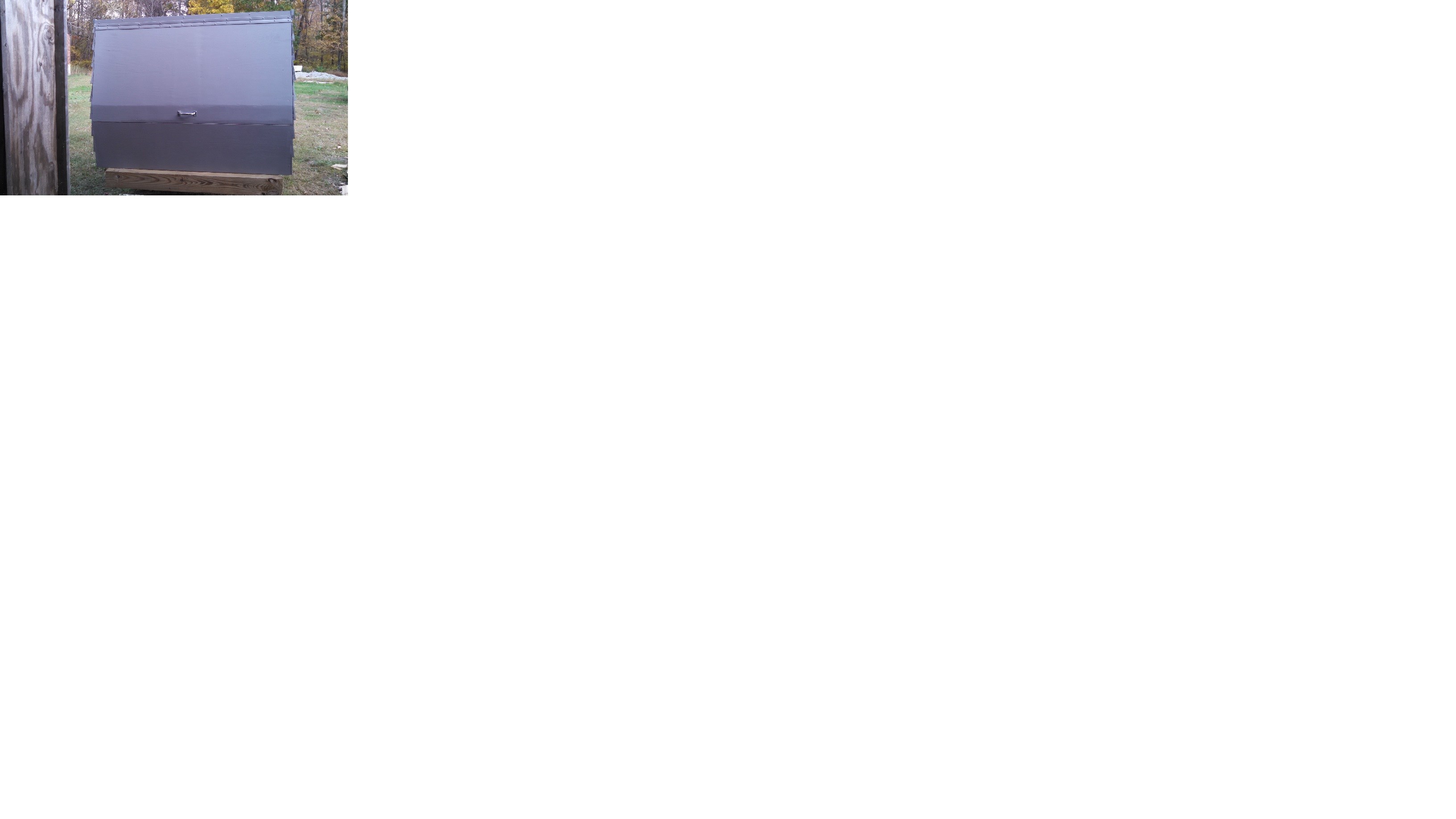

Postby Danidog » Tue Oct 28, 2014 5:38 pm
Got some color on it today.

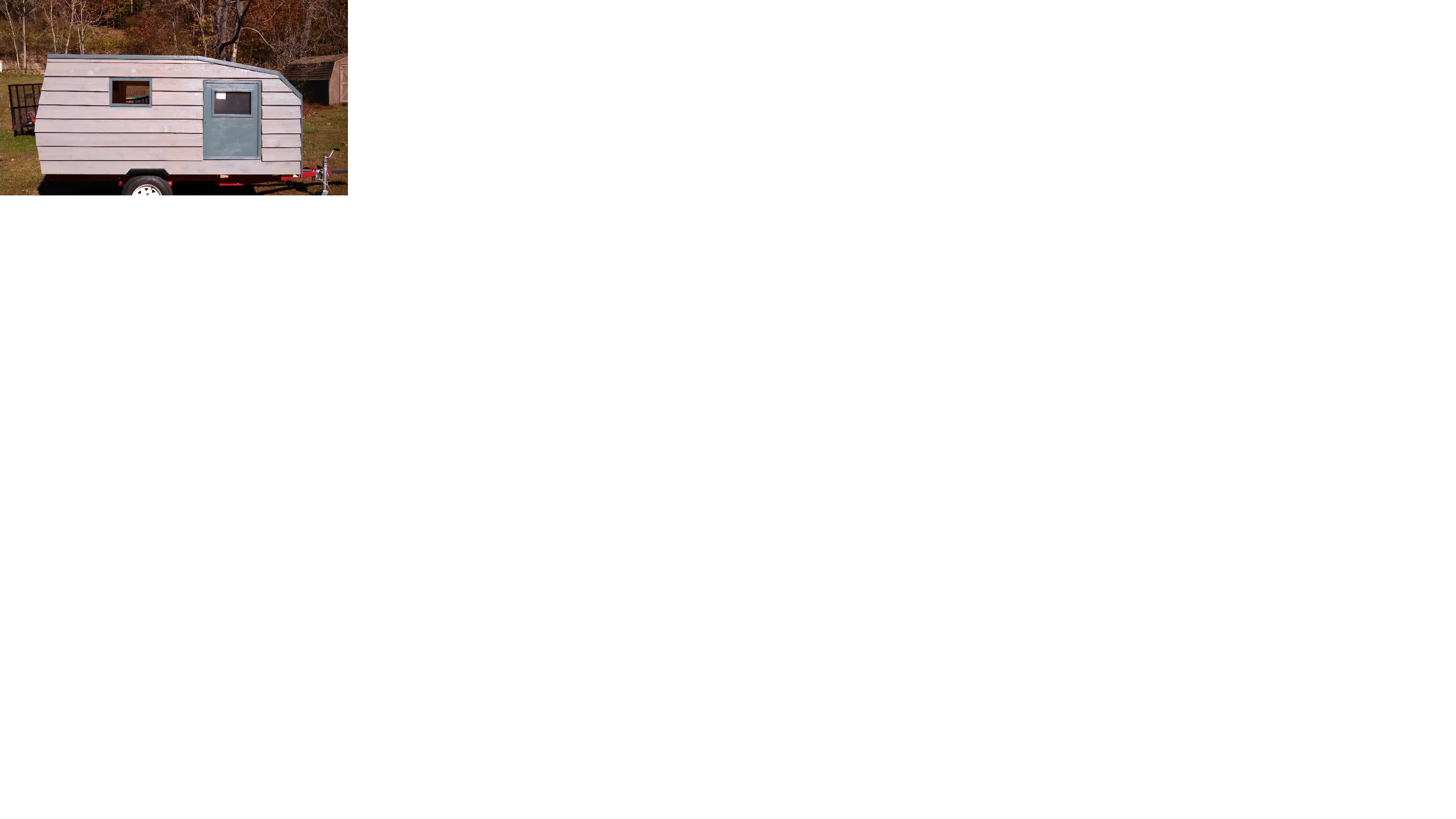

Postby Danidog » Tue Oct 28, 2014 5:47 pm
bumper mockup.jpg (206.27 KiB) Viewed 7968 times
Starting to work the 4 x 6 into a rear bumper. The lights will be installed on the very ends of the bumper, but still just under the siding to fill in the rest of the width.
Again the color is off. This paint is the same silver/grey as the siding paint.
After winter is over, I plan on putting the siding on the back, from the hinge down to the bumper. Running out of time right now, have to be camp-able within the next few weeks.
