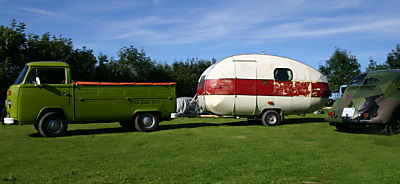

del wrote:Does anyone know where a web cite is for SMV trailers?

What alternatives to ply are out there? Light weight, durable and inexpensive are all factors? The caravans (trailers) from the fifties do not appear to be as blended.angib wrote:I think if you want to build it in plywood, forget it. The four corners will need to be separate pieces and they will look a lot less smooth than in the SMV trailer - the end result won't look as good and the extra work is scary.
Incorporating either just the top and bottom curvature, or just the front and back curvature is quite doable and almost easy with your epoxy skills - it would be trying to combine both types of curvature that would give you nightmares.....
Andrew
