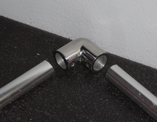

Schaney , thinking about a universal tubing coupler ... tubing , inner third flattened , cross that with another of the same (perpendicular) Bolt or rivet that together ... each leg could be bent to accommodate the various angles of most any frame ... Just an idea for we homebuilders ... :roll:
Postby schaney » Sun Jul 11, 2010 7:42 pm
My initital thought is your structure would flex more than desired joining that way.
One home-building alternative is using couplers. Although you are somewhat limit in the angles available and they add cost.
Scott
Camping the "Compact Way"
schaney
Posts: 804
Images: 262
Joined: Tue May 02, 2006 9:27 pm
Location: Salem, OR
Postby GPW » Tue Jul 13, 2010 6:47 am
Schaney , it was just an idea to produce an inexpensive way to couple tubing for frames... I think by the time you buy all those commercial couplers , you could have had it welded by an expert ... I did some PVC constructions a while back(not a trailer) ... the fittings were more expensive than the tubing .... :o
