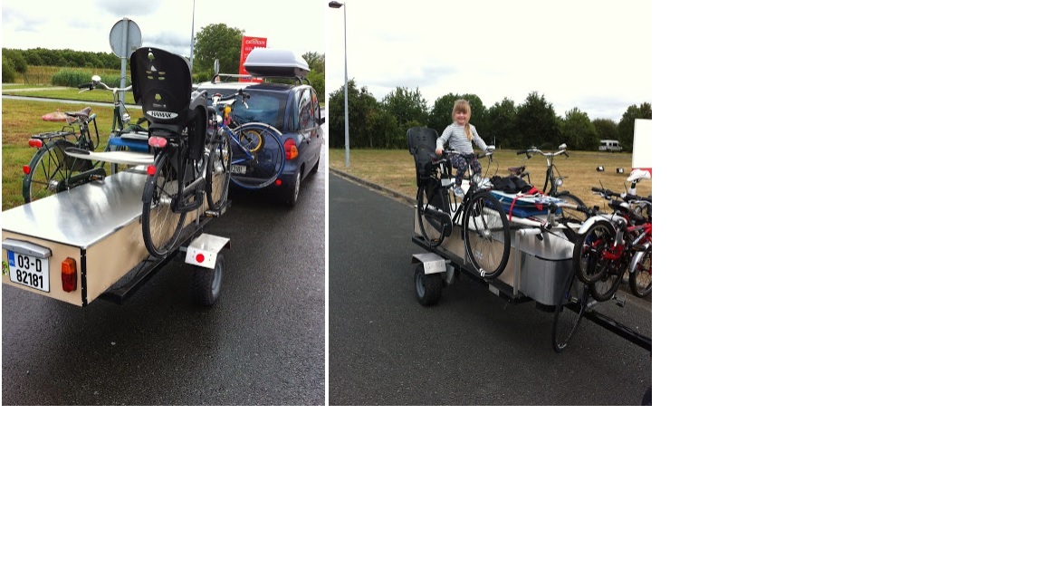

Incidentally I did build my own trailer about 5 years ago for long haul trips to France (im in Ireland).
Ill try get a few photos of it here.
Marty.
