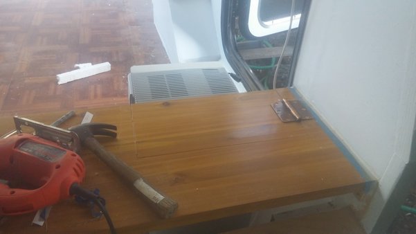

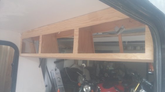

First, I worked on the cupboard. The bottom and both sides are done. I'm waiting for hinges and pulls before adding the doors. There's a little pass-through in the middle where paper towels and other things will live. When I was done with that, I hit the usual gaps with wood filler.

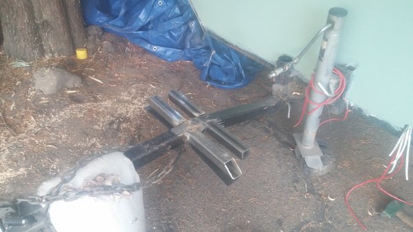

I only tack-welded everything together, but the part I'd been dreading was figuring out the structure - something that needed solving before the storage boxes at the front of the trailer could be built. I ended up tacking together a little tray and then tacking it to the trailer. I stuck a single 1.5"x1.5" square tube on the bottom of the tray and then sandwiched it in with two square tubes on the trailer. I'll drill through all three pieces and put a pin or bolts through there so that the tray is removable. When I was done, I just broke the tray free of the trailer and carried it into the garage.
Obviously, all the welds need to be completed, the ends of tubes closed up, and rough edges smoothed out. But I think it's going to work! The steel structure for the front storage boxes will connect to the motorcycle tray mount, adding rigidity. I'll probably build a matching ramp that hooks onto the tray and somehow mounts to the trailer. I might also brace the structure back to the trailer in the front to reinforce that. And the propane needs to go up there somewhere. Oh, and tie-downs for the motorcycle.

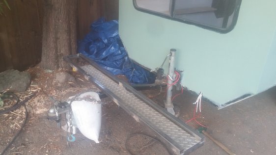

Postby artquixotic » Fri Sep 16, 2016 6:39 pm

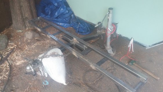

I spent about 6 hours on the trailer today, getting ready for rain starting tonight. I spent almost the entire time welding - waiting for the welder's cycle time. So in 5-10-minute spurts, I cleaned up the edges of the rubber roof, waited for that to dry, and then put adhesive silicone over the staples. I'm opting not to put silicone around the actual edges of the rubber roof because it's already got redundancies built in. I also taped around all of the even slightly suspicious looking screws holding the plexiglass in, and then sealed around those with silicone sealant too.

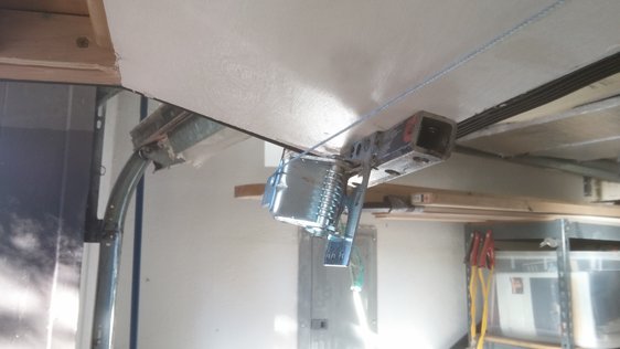

I also found some interference between the rear hatch lift support and the cupboard face, so that needs attention soon. Hopefully the hatch being open slightly doesn't cause much water intrusion. I started bridging the unrelated gap between the weather strip and the trailer too. I put some silicone around the newly installed drip molding around the doors. I still haven't sealed up the screws holding those on - or the screws holding the new lower-side protection pieces either.
Some USB ports came in, so I hollowed out a wood block that holds the wiring. I'll attach it to the back wall with the USB ports on top. I need to build one more. And it just occurred to me that I need to build in a switch too, because the USB-powered lights I bought don't have switches.

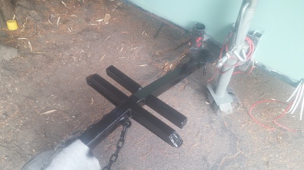

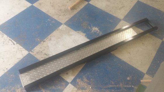

After the motorcycle tray was all welded up, I cleaned, degreased, primed, and painted it and then stuck the diamond plate in. I did the same with the supports on the trailer. I chose some less-than-ideal plates to cover the ends of the square tubes, and so they look pretty crappy now. Function over form, I suppose. I cut myself pretty good with a sharp edge, so I spent some time smoothing everything out with a flap disc. Both the tray and trailer now need four holes drilled for the big U-bolts that will act as pins to keep them attached. And I gathered up some eye bolts for tie-downs, so those need homes to be welded to soon.
Rather than cover the trailer up, tonight will be a test to find any obvious leaks. Cross all your fingers and toes!

I also chiseled down the block that holds the hatch lift support to prevent it from interfering with the cabinet. The hatch light also bumped into the cabinet, so I moved that down slightly. I'm going to need to move the hatch wire to prevent drooping and pinching when the hatch closes.

In the garage, I riveted the diamond plate to the motorcycle tray. The diamond plate bows a little when I walk on it, but I think I'll forego more reinforcement. It's strong.

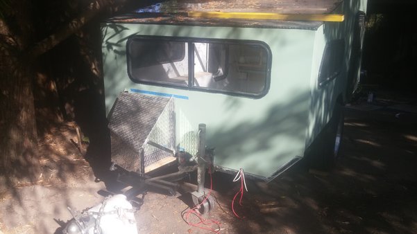

I spent six hours today making an ugly box for the front of the trailer. It's pretty solid, but I had to lower the front part when I realized it would interfere with a motorcycle on the tray. I didn't realize until too late that the structure ruins my plans for U-bolts to temporarily hold the tray in place. In good news, the pivot for the front wheel/jack can still pivot. However, the trailer no longer tilts - the new welds prevent that. No big loss.

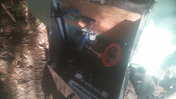

I think I worked on the trailer for about 3.5 hours today. The photos reflect how little there is to show. I mostly worked on the electrical box. I installed the hinge for the lid, caulked the hell out of everything, and made a backplate for mounting electrical stuff. I installed the battery, and there's room for another later if needed. I drilled a 2" hole for the AC inlet. The main switch is wired. I established a good ground. A fuse panel is ready to be wired and labeled. Pretty much everything is waiting for additional parts (AC wire, terminals, DC wire, etc.) that are in the mail.

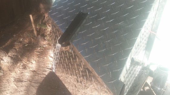

I also welded on a couple of solid tie-down points for the motorcycle. But they would be trying to turn the handlebars, so I've got to figure out what to do about that.

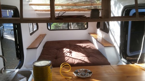

The mattress came, and that's got me excited. But I want to finish the side compartments in the interior before putting the mattress in there.

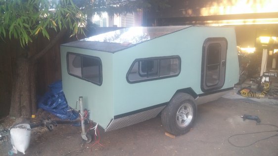

I hereby declare this a camper trailer. So it appears that I created a camper trailer. Nice!

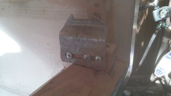

After about 7.5 hours of work yesterday, I had installed the latching/locking mechanism (it's ugly but works well), trimmed the front cupboards/counters, cut ugly hinging doors into those, vacuumed everything, and threw the bed in. I sat on the bed for a few minutes just to get a feel for it, and it looks like a camper. Obviously, there is a long list of things that still need to be done. I won't clutter this post with that. But it's mostly cosmetic. And there are a lot of parts in the mail that I need to install as they arrive. There's still no propane system, and the optional items waiting for me to find a job (e.g., furnace) are still in limbo. And the motorcycle tray is still missing pins or bolts to hold it to the trailer.

I worked on the trailer for a couple of hours today before I was pulled away by an emergency. I had finished the exterior paint and attached the motorcycle tray to the trailer with three big bolts. I had also jumped up and down on the ends of the tray, and there was motion, but I think the motion was all in the tires and suspension. I've chosen a basic strategy for building the ramp and the dimensions of that. No parts came in the mail yet :(
