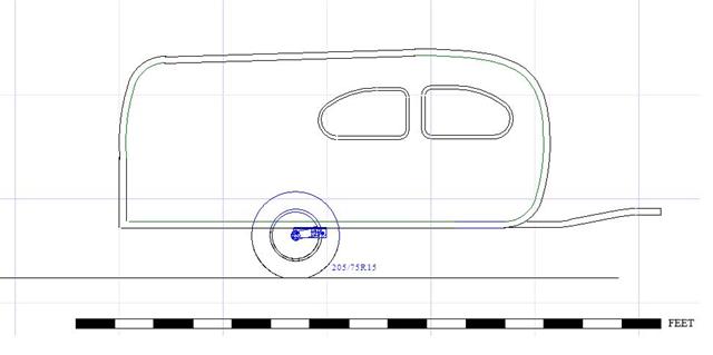

I've been trying to come up with a profile I like for the Compact. I really like the Cabin Car but I like the interior room of the Compact. Sooo, I crudely had my way with Andrew's drawing of the Cabin Car.
I copied the front bottom curve for the back top curve. The last 5' of the top, up to where it slopes down, will pop up. The door in the back will be hard to build but not any more so than the dreaded hatch. Oh, and it will be 6.5' wide so the bed can go from side-to-side. So what does everyone think? Is this too ugly to pursue or is there hope for it?

Bruce...I like it...but I'm confused on how the the back pops up...really a practical trailer, plenty of room...windows in the front too? Starting this winter? Doug
Postby bdosborn » Tue Aug 15, 2006 12:23 am
No hatch in the back, just a door to get inside, like a truck camper. It would be tricky to build because it will need to follow the curve up and its probably prone to leaks. I think the front foot or so will be a closet, like the Road Titan, so no window in the front. I've been buying parts on the sly so I can put together a mock up of whatever design I go with. I might get started this winter, depends if I can get enough done around the house before hand. ;)

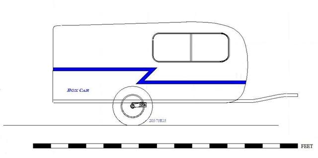

Well, part of my goal in this project is to simplify the construction so I think I'll just change the profile instead. A small radius at the back top corner should fix it, say about 2" maybe? I'll have to check and see what the minimum bending radius of Filon is.
Oh, and I changed the window to the one shown in the compact.

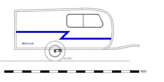

I used TurboCad. I downloaded it for free from somewhere, didn't save a link.
I fixed the window, I like this better...

Yeah, you're right again. I went back and looked at the NASA paper you posted awhile back and a full boat tail rear was barely better than a flat one. I have to figure out a way to integrate the popup roof and solar panel so that they don't cause a bunch of drag. Maybe a fairing on the front of the solar panel since it will be closer to the front than the pop-up. I sloped the rear of the Boxcar at a guessed at 15 degrees. I'll refine it a bit as my CAD skills progress. I also plan on experimenting with vortex generators across the top of the back.
