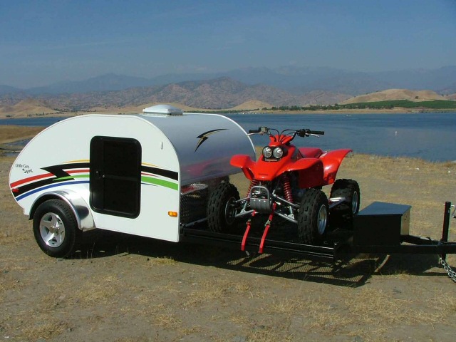

Little Guy sells an ATV/Teardrop. http://www.golittleguy.com/sixsport.html# Just as a thought.
I'm sure that it could be home built. The big thing to consider is tougue weight. With the ATV on it you would have alot of tongue weight. Can your tow vehicle handle it? They show their tongue weight at 140#. I'm sure that is with out an ATV on.

Normally there would be an issue with the wheel & fender interfering with the door opening when locating the axle in the center of the trailer, here's one trailer that worked around that problem.
I imagine you could build something similar to this with the extended tongue to allow room to mount a quad or other sport vehicle.
