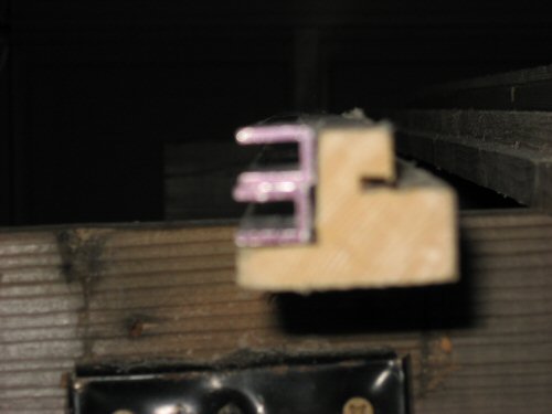

One thing you can do is make a slider just like you woud do for a cabinet. You can get the slider rails form the hardware store. HD may tell you they can't get them. Put one on top and one on bottom and some bracing in the door so it is rigid enough. Perhaps make a narrow Luan hollow core type door. it will be lighter weight and not have the warping issues of 1/4 ply.
This is a picture of a practice slider I made to go across the middle of my bulkhead.

Leslie the picture shows 1/4 aluminum channel. The premade rails are the same but they have an screw strip on one side. That is what you want. They are much cheaper. They are more than heavy duty enough.
Since it is 1/4 inch you can use 1/8 anything or or door skins (usually $6 dollars) and make a hollow core. The sandwich can be any thickness but the edge going in needs to stay at 1/4" thickness.
