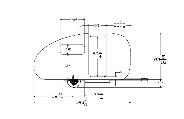

Postby Dewayne_Mellen » Mon Apr 16, 2007 9:02 pm
Mike do you have any of the measurments on that trailer?
Dewayne_Mellen
Posts: 78
Joined: Wed Feb 15, 2006 9:30 pm
Location: Redford MI
Postby mikeschn » Fri Apr 27, 2007 5:28 pm
Dewayne,
Are you looking for overall dimensions, or enough detail to build it with?
Postby Dewayne_Mellen » Fri Apr 27, 2007 9:20 pm
Overall would be good.
Dewayne_Mellen
Posts: 78
Postby mikeschn » Sat Apr 28, 2007 6:26 am
Here are some overall dims...
