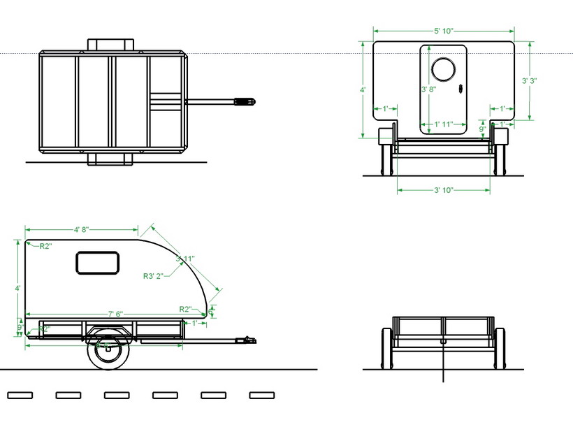

Postby Grimrot » Tue Jul 17, 2007 8:58 pm
I broke down an refreshed my memory of SketchUp. No 3d, just 2d drafting. No pop top and I'm starting to think it's too wide for the trailer but it's a first pass.

Postby Miriam C. » Tue Jul 17, 2007 9:14 pm
:applause: CAD looks good GR. Have you seen Rae's wagon? It might give you some ideas to work with.
http://www.enslin.com/rae/gypsy/vardo01.html
I have about 850 pounds in wood (that's what I bought) and mine is bigggggg, so you can make it if you watch what you put in.

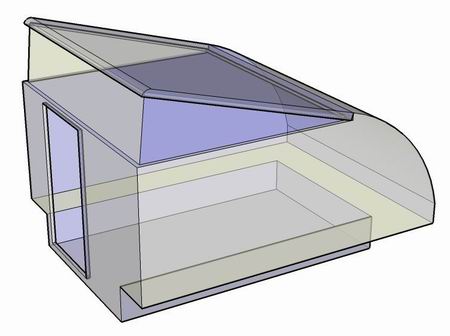

Postby steve wolverton » Wed Jul 18, 2007 4:57 pm
Grimrot wrote:Steve - I really like that idea. Lifting with a boat could be a challenge but might work...
Nice rendering. I'd just take the boats off to lift the hatch and place them back on when it's lifted.
Also, depending on how much canvans you want, that hatch could raise up all the way vertically and that would give you a ton of room inside. (Obviously you wouldn't be able to keep the boats on there if you did that)
You could also sew clear vinyl in the canvas to let a ton of light in, and you wouldn't need any windows, or could use smaller ones. That would save quite a bit of weight too.

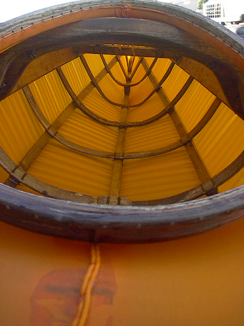

Postby Grimrot » Wed Jul 18, 2007 7:44 pm
Go ahead an just build a 1x2 birch frame and skin it like a West Greenland Style Kayak? Canvas Duck and Epoxy instead of Polyurethane. I bet I could keep it under 250lbs with a 4mm Okuma ply top and front.
