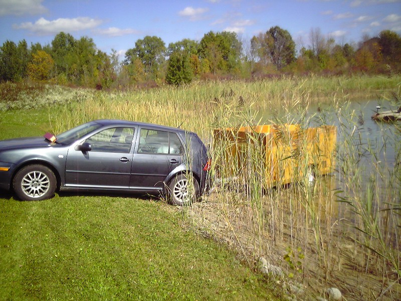

Postby coal_burner » Mon Oct 01, 2007 5:00 pm
This is what the trailer looks like being backed into the lake for the first time. the pic shows it in about 6" of water, so it's still supported by it's wheels.

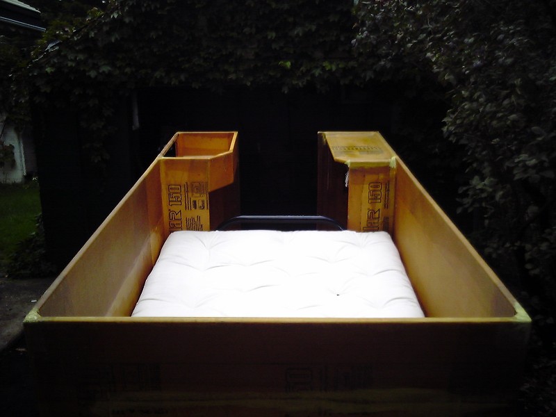

Postby coal_burner » Mon Oct 01, 2007 5:57 pm
this picture was taken standing on the tongue looking over the futon/bed.
You can see the cabinet boxes to the left and right of the doorway. Between the cabinets is about 2' by 2 1/2' of open floor space for changing clothes.
eventually there will be a one burner stove, sink, and microwave on the left.
The refrigerator and air conditioner are going to be fit in the right cabinet.

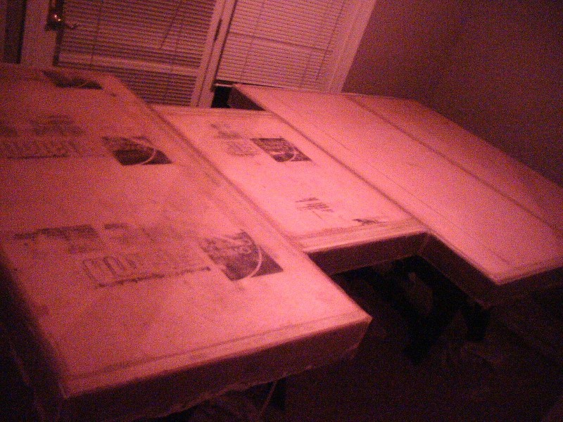

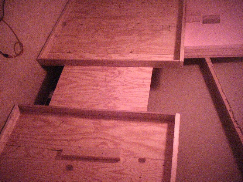

old pics
Postby coal_burner » Wed Oct 03, 2007 7:32 am
I was just able to locate some of my oldest building pics(from last spring).
here is A picture of the underside of my torsion box, before the foam and fiberglass were added.
And here is the same box after the foam and the first layer of fiberglass was added.
Since the last pic I had also added stacks of three 1x4s on each side to give me a good place to bolt the axle to.
There are 4 3/8" captured nuts buried in each stack of 1x4s to mount the axle to.
If you look closely you can see a shadow running diagonally up from the bottom left of the picture. That is where the 4ft wide sheets of fiberglass that I layed diagonally overlapped.
The second layer goes on horizontally, which gives me alot more rigidity. No matter where the deck tries to flex, it will be putting some of the fiberglass strands in tension.
If I had this to do over again, I would completely omit all of the wood framing and decking. I could have saved at least 75 LBS.
