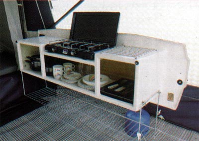

The short-lived R-Vision Cassette is a square-backed but otherwise teardrop trailer - the roof is high enough that the galley door is a hatch which swings upward (hinge along the top edge) and forms a roof over the area behind the trailer.
For a trailer which is not that tall, a rear hatch could be cut forward into the trailer body, so that the hinge line is forward of the rear edge of the roof. When the hatch is swung up 90 degrees, the hatch is higher than it would normally be, and can act like the Cassette's roof.

Postby angib » Sat Oct 13, 2007 3:37 pm
brian_bp wrote:For a trailer which is not that tall, a rear hatch could be cut forward into the trailer body...

Postby brian_bp » Mon Oct 15, 2007 6:40 pm
Andrew
Exactly - thanks for the illustration. :thumbsup:

Postby brian_bp » Mon Oct 15, 2007 6:42 pm
The Cassette is more of a plain box than Steve's design, but has essentially the same hatch and galley layout.
