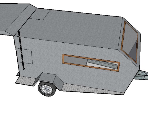

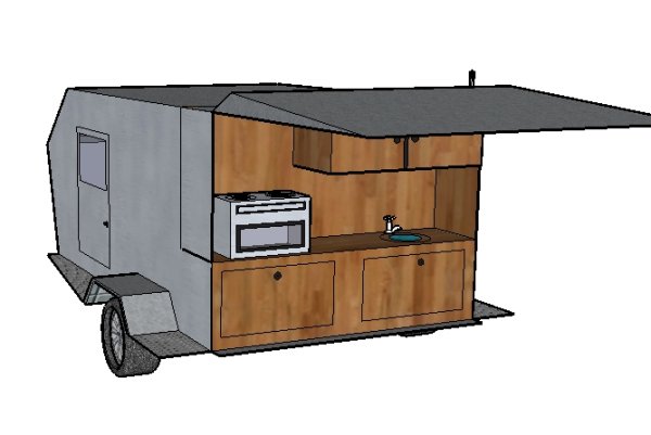

Postby rabs » Thu Dec 13, 2007 6:36 am
Hi all, Just thought i would put up the sketches of my Grasshopper/Mini Hopper kinda style of trailer, It will be painted in Urban Camo if i can figure out how to paint it..Please let me know what you think or any info you want

Postby GPW » Thu Dec 13, 2007 7:31 am
That's Very Nice!!!! Might need a rock guard for the front window...and how do you get to the beer on a rainy day ??? :o
Postby bobhenry » Thu Dec 13, 2007 7:38 am
Here's my brain fart design ! I posted it for 1 reason.
Notice the hinge point extends back about a foot. I did this to avoid the headache factor. The box on this one is only 4' tall plus the 17"-18" for the trailer frame height puts the open hatch at 5'6" a real forehead buster if you don't learn to duck. By moving the hinge point forward I will gain 12"+/- when opened. You might check your height when open and you may want to concider this in your design. :thumbsup:

Postby rabs » Thu Dec 13, 2007 7:38 am
Ye that is an important issue that Ill need to resolve, :o perhaps an emergency beer door that i can access from the inside :thinking:

Postby rabs » Thu Dec 13, 2007 7:49 am
Thanks Bobhenry, The actual height of the door when lifted should be about 6' 5", being height of cab is 1200mm + sitting on trailer bed which should be about 800mm, allowing for leaf springs and offroad tyres 6'5" should be about right, but having said that yes i will keep it in mind..being a short arse myself :cry: I forget to allow for non vertically challenged people..

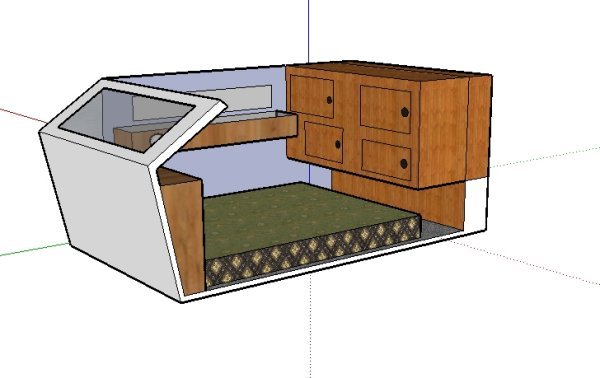

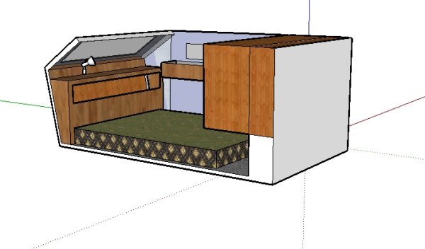

Just thought i would add a couple of interior shots I'm hoping to use

Postby tonyj » Sat Dec 15, 2007 11:00 am
On your interior, make sure to provide extra height between the mattress and the bulkhead cabinets. You don't want to cramp your feet or crunch your toes every time you shift your sleeping position.
