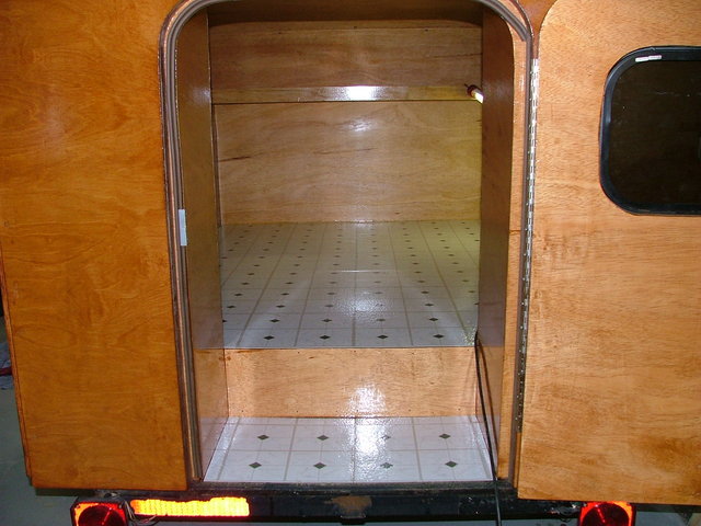

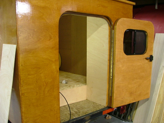

You might look at Warpony's first trailer with the door at the back ( my stand-up trailer will be like this when I get it that far ).
Warpony I hope you don't mind me posting the pictures.

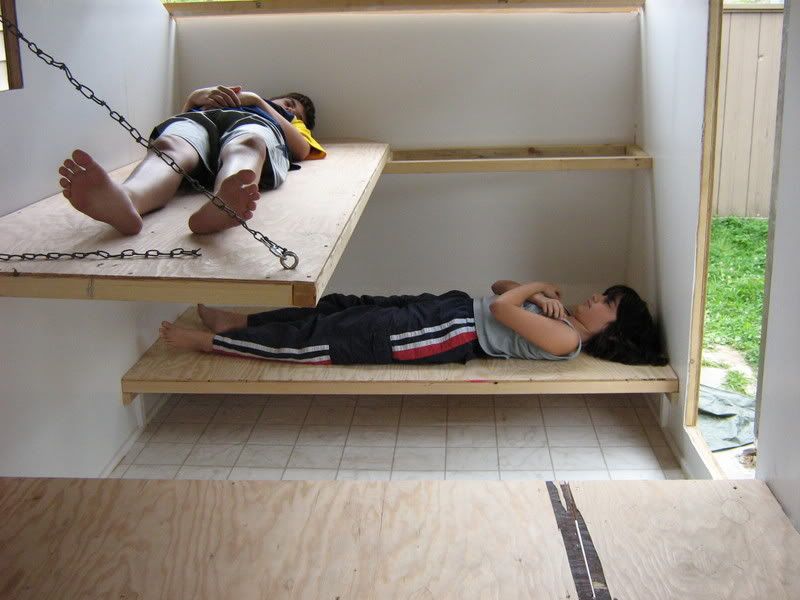

Your daughter will be best served on the lower bunk so she can move around. How old is she? Is the ride powered and heavy. Good luck with the build.

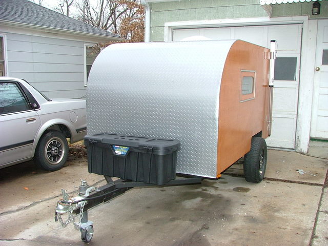

If you look at Scott's "rolling stone" in the Hall of fame, it is on an old pop up too. He has 8 inch tires and left his axle short. Much lower profile. His is also only 4' tall I think. It also has 8" tires.

:lol: I understand monkeys. Raised a few that took after their mom. ;) I don't know any reason a counter won't work. If you look at a lot of TD builds you will see pretty much anything goes. Remember that a bunk over your bed means you need it to fold down to make way for a table.
