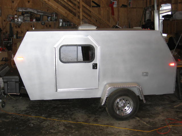

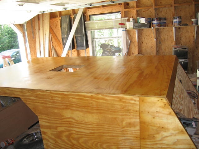

During my planning stages I considered a split pitched roof, ~4 foot would have pitched toward the front and ~5 foot would have pitched toward the back. For several reasons (mostly less complicated) I went with a flat top front to rear. So far, I’m very happy with the results and no problems with any type of leakage (epoxy over plywood const.). I figure that if I ever thought about water pooling, I’d just crank the front up a bit and let the water run off the back until the rain stopped. I store it under cover when it's not in use, if I were to store it outside the front would be left higher than the rear. As it's been said several ways before; this doesn't mean it's the only or best way to do it! It's just the way I did it.

MacGyver, That is one sweet lookin trailer well done, :applause: Is that skinned with anything or painted

Thank you Rabs. Without the wealth of information from this site, it most likely wouldn’t have become a reality. Which reminds me, it’s past time to pony up with a donation. :D The plywood was sealed with one cost of epoxy prior to final assemble, then a second coat with a layer of cloth after assemble, and the final third coat to hide the cloth weave. It was then followed up by some power sanding, one coat of epoxy paint primer and then two coats of a single stage automotive silver epoxy paint. The picture above will give you an idea what it looked like without the paint.

Thanks for the info MacGyver, That is a really nice finish and looks very flash, good paint job I must say, I'm going to use similar primers, sealers and top coats so hope mine comes out just as good, again well done :applause: Just as a side issue what are your dimensions of your trailer

Well thanks again, when it comes to painting I’m very much an amateur that just asked lots of questions before I sprayed it. The frame area is ~1.524m wide by ~2.74m long and the sidewall at it’s longest is ~3m in length. After reading previous discussions on interior space, I opted to make the cabin area large enough for a queen size mattress to ensure a comfortable sleep for the wife and I. If you’re undecided and haven’t already done so, you might want to check out mattress width using the “search for all items” feature. It will give you plenty of tried and true things to consider in your planning.
