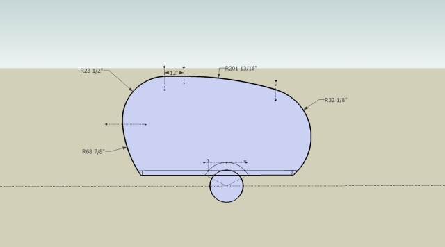

Postby pELF28p » Sun Mar 02, 2008 12:11 pm
Can anybody help me figure out how to loft the curves from this picture to plywood (for wall construction)? What does everyone consider to be the easiest method?
Thanks.

Postby Juneaudave » Sun Mar 02, 2008 12:55 pm
Nice profile...the only suggestion I can offer is to lay out some reference lines on the ply and measure accordingly. When lofting a design, I always take a thin strip of "bend-able" material to check the curves and assure that the transitions are fair.

Postby deputydogrick » Tue Mar 04, 2008 9:21 am
I use a pole compass and a string compass on a large full size sheet of oaktag, then use this as a template, after I lay the work out on wood, I clean up the curves with the compasses. Good luck

Postby grant whipp » Tue Mar 04, 2008 2:00 pm
If you can get hold of an overhead projector, print out the image and project it right on to your plywood and trace ... :thumbsup: ...
... "oblique"projectors can use the printed image, the other kind requires that you have it copied onto a transparancy sheet (wich any copy shop can do for less than a buck) ...
This works especially well when your drafting doesn't match your sketches ... ;) ... ;) ...

Postby tddriver » Tue Mar 04, 2008 2:23 pm
Grant[/quote]
Plain paper drawings treated with vegatable oil can make a serviceable transparancy in a pinch. :thumbsup: 8)

Postby eamarquardt » Wed Mar 05, 2008 12:07 pm
I don't have an overhead projector for transparencies. What I've done is take a picture with slide film with a 35mm camera and then projected the slide on the "template to be" and traced out the pattern. Worked well enough to turn some legs for a cannon ball bed.
Another thought is to take measurements in a grid pattern, enlarge the unit of the grid as required, plot the dots of the pattern to be, and then connect the dots. I have done a loft of my side profile using plywood and schedule 125 1/2" pvc pipe held in place with conduit clamps. See album. It worked really nice.

Postby rbeemer » Fri Mar 07, 2008 3:58 pm
If you do not have an overhead project...No problem
Take your transparency and tape it to a piece of cardboard or wooden frame.
If you shine the light from behind onto your plywood your image will be there.

Postby Cliffmeister2000 » Mon May 26, 2008 9:47 pm
eamarquardt wrote:I don't have an overhead projector for transparencies. What I've done is take a picture with slide film with a 35mm camera and then projected the slide on the "template to be" and traced out the pattern. Worked well enough to turn some legs for a cannon ball bed.
Depending on what you made your drawing with, you could probably get it into a JPG format and have it made directly into a slide at Ritz or maybe even Costco. And you can rent a slide projector, or probably find one at a yard sale for under $10

Postby Steve_Cox » Tue May 27, 2008 8:33 am
Joe,
21st century response: Computer Projector. With one of those babies you can take the laptop to the garage and shoot pictures teardrops onto your sheet of plywood all day long. :lol: I want one!
