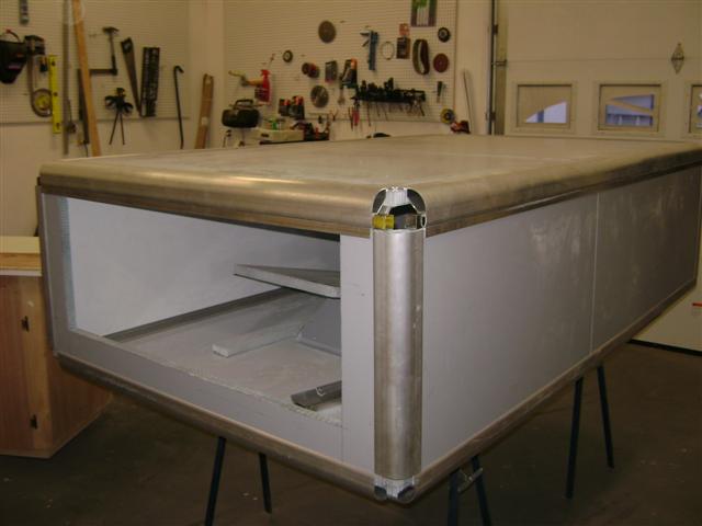

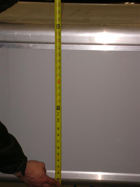

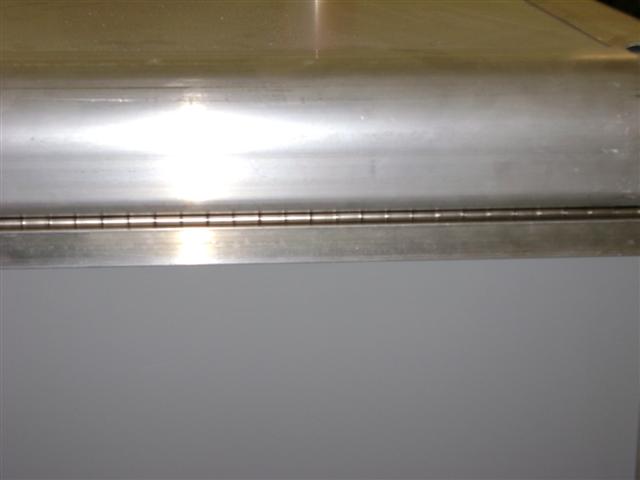

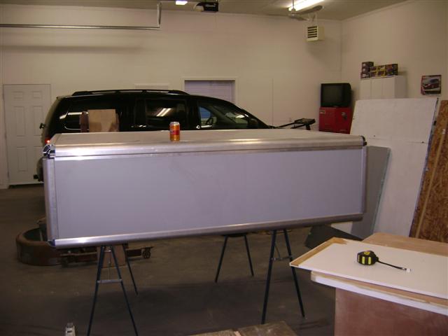

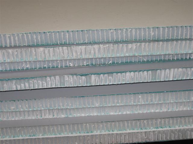

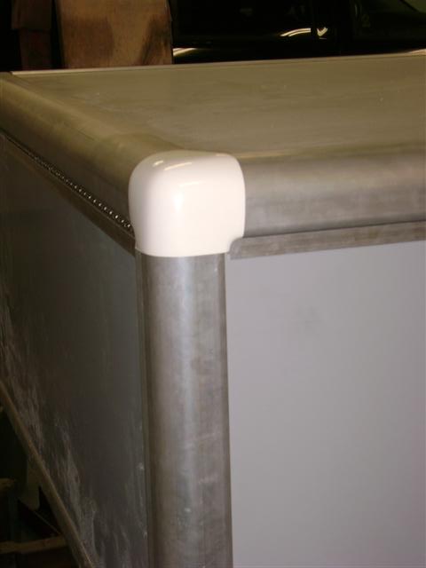

I was at a friends shop helping him with a comercial build and was fortunate enought to talk him out of some of his composite honeycomb structural panels. As soon as I got home I started on my build and here are a few pics of what I have accomplished so far. the trailer box inthe photos is just dry fitted together for now. This stuff was too expensive to take any chances with but I think it will be very nice when completed.
I am am using a composite honeycomb panel with aluminum on one side and filon on the other. The panels are 1 inch thick and everything is held together with aluminum extrusion and structural adhesive.
