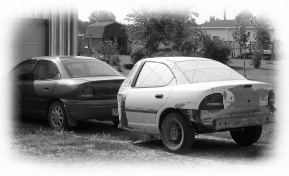

Postby groys02 » Mon Jul 07, 2008 10:02 pm
Hallelujah!
Trailer hitch installed, and it was off down the road behind my trusty 95! Seemed to me it towed just fine, with only a "medium" amount of drag, and no wandering around, or pushing me around when braking. Weighed it at local Coop--820 lbs at this point. Haven't checked the tongue weight, but I can lift it at the hitch and move it around myself, so can't be too bad.
More work since on the bed platform, and found a rear bumper cover---now painted with epoxy grey primer and installed. Soon hope to have the panels fabricated/installed between sleep area and galley. (I'll keep adding a few pics here and there to my personal album.) Also hope to fabricate a mount for the spare underneath the former trunk area soon...
Then it's back to metal smoothing/filling/painting... then interior work.

groys02 wrote:Hallelujah!

Right now I'm building the bulkhead between sleeping area and galley, and wrestling with fabricating a spare tire mount under the rear section (to help keep the tongue weight reasonable--175lbs currently, with the pretty much empty shell). I'll add some pics of that stuff later this weekend, hopefully.
