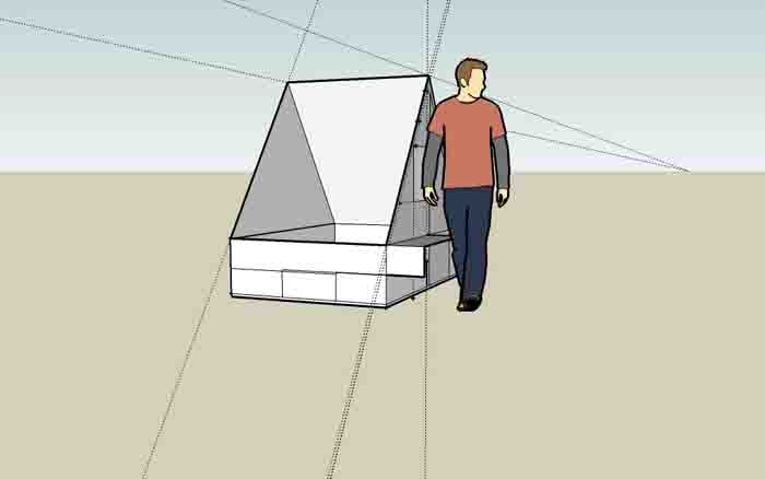

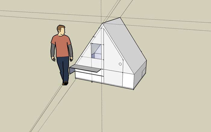

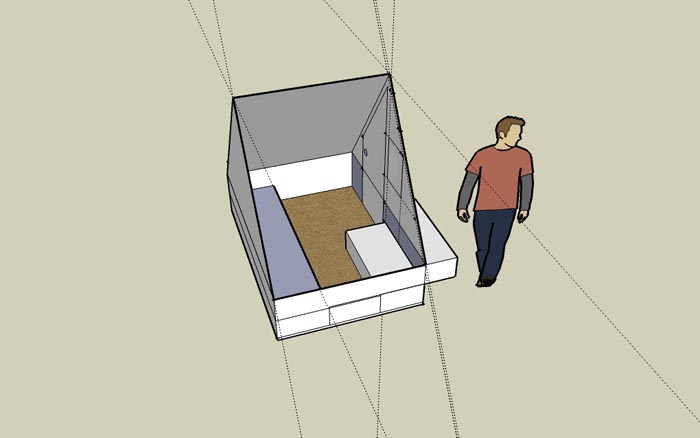

Postby scottyp » Thu Jul 17, 2008 8:27 am
this is what I've come up w/ so far
