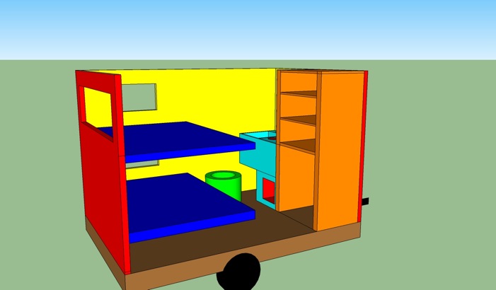

I drew this plan in Sketchup. How do I post it so so you guys can see it and give me advice?

Postby Myke » Fri Jan 02, 2009 8:26 pm
Here ya go Myke. Doug

Postby Myke » Fri Jan 02, 2009 9:23 pm
Thanks Doug, I was getting there.
I posted dimensions in the first post so hopefully somebody can let me know if the axle looks right for the weight. The dark blue are the bunks, light blue stove, sink and furnace location, orange is food and suitcase storage, green is a porta potty. This will be left long term on an acre mountain property, so I will build a picnic table. I think it will be crowded, but I don't go to the mountains to sit in a camper. The camper is just to sleep in.
Any advice or modification suggestions are welcome and appreciated.

Postby Miriam C. » Fri Jan 02, 2009 9:24 pm
Something to consider for children is you can run them perpendicular under or over the adults. That way there is no back person and no need for extra venting.

Postby Myke » Fri Jan 02, 2009 9:45 pm
Auntie M,
the problem with running the kids bed the other way is it sticks to far out into the walkway. I'm kind of limited, because I have the trailer and don't want to spend all my money modifying the trailer to get a better floor plan. Yes, I have checked out the tiny house on wheels section. This popup is to camp in while I build the tiny house on wheels. I've already drawn the tiny house in autoCAD. That was better, because I was able to get all the dimensions, lay it out and then decide what size trailer I needed. After I get the cabin trailer built, I will give this trailer to my brother to camp in and I will build a weekender for me when I go on trips and only one of my daughters wants to go with me. So if the economy allows, I hope to be in the 3 build club by next fall.

Postby Miriam C. » Fri Jan 02, 2009 10:55 pm

I take it the Kidlets are too tall to go across the existing 54". Keep looking until you get the walls up. You might be surprised what you can come up with.
Postby Myke » Sat Jan 03, 2009 12:13 am
Dang it Auntie M. You got me to thinking, the oldest will be 16 in March, so I'll be lucky to get her out in the woods very often. The youngest is only 9, so with building the tiny house on wheels this summer, I might be better off building a normal 2 person teardrop. Maybe put a bunk in it in case I need 3 person bedding, but removable for when it's just the wife and I. Back to the drawing board.
