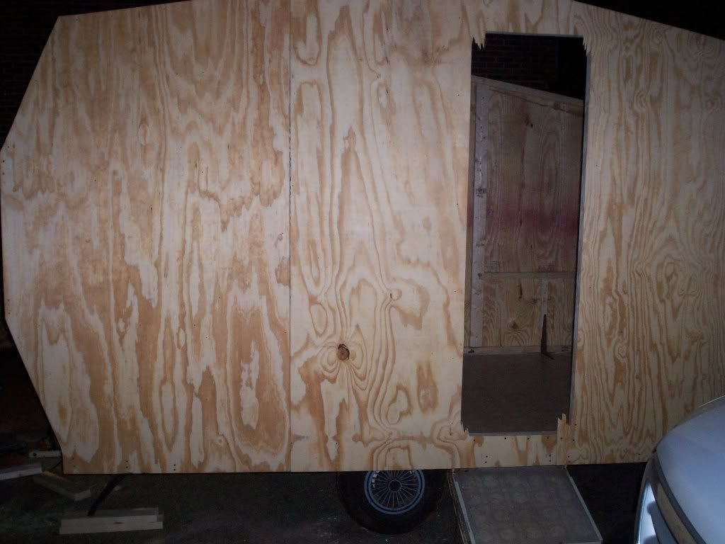

Well I have finally begun construction on the Stand Up. I stripped the camper down to the floor last weekend. Tonight I got the second of the sidewalls framed and sheathed. I did one on Wed evening. Last night was golf leaugue so nothing happened build wise. Here is the cad file I used, not sure who to gice the credit to. I found it on here somewhere, just cannot remember where.
Heare are some of the construction photo's my 9 year old boy took most of the pics so far.
Image.
I will be back at it tomorrow. As for ammenities, it will have one 48" master bunk. @ bunkies on opposite end for the two kids. The top bunk will swing down to form a goucho during the day. A small dropdown dinette for kids friend's/cousins. Sink, 3 burner stove, dorm fridge, TV and DVD. Wish me luck. I am giving myself an aggresive deadline of May 1 for maiden voyage. There is a semi-yearly camping event with work collegues scheduled for that weekend.

Well I got the entire thing sheathed yesterday. I am very impressed with the rigidity of it. It seems quite solid. I used liquid nails and 3 1/2" lag screws to hold in the spars. And LN's under the sheathing and screwed it into place. I used carraige bolts to attach the bottom of the sides to the trailer. Trying to decide on the siding and roof material.

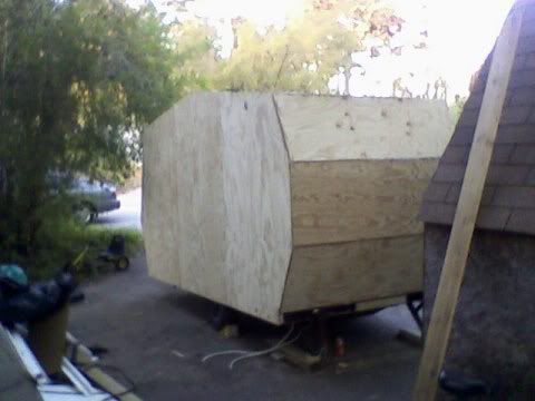

Postby ready2camp » Wed Apr 22, 2009 4:44 pm
Here are a few more pics.
Working on sealing the seams and interior framing now.

Postby ready2camp » Thu Apr 23, 2009 5:07 am
Mine is around 75" high in the center. There is plenty of headroom for me. I am about 6'1".
I built the bases for the dinette seats last night. I re-used the metal frames for the seat supports as well as some corner brackets from the pop-up. I has plenty of 4' x 17" pcs of plywood left from the sheathing cut for the sides. Waste not want not, that's what Granny always said. I am re-using the Dinette cushions as well, but I will be recovering them first.
I am taking a vacation day tomorrow to get a big 2-day push on it. I am leary about making the May first completion date, but I am very pleased with my progress so far. Michelle is just happy it resembles a camper. :lol:
