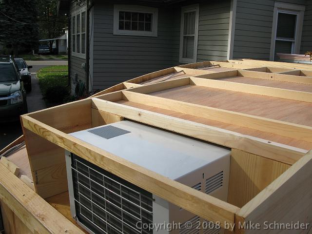

Postby mikeschn » Fri Jul 17, 2009 3:55 pm
Hey Chip...
Cheap... simple...
attractive!!!
A/C
