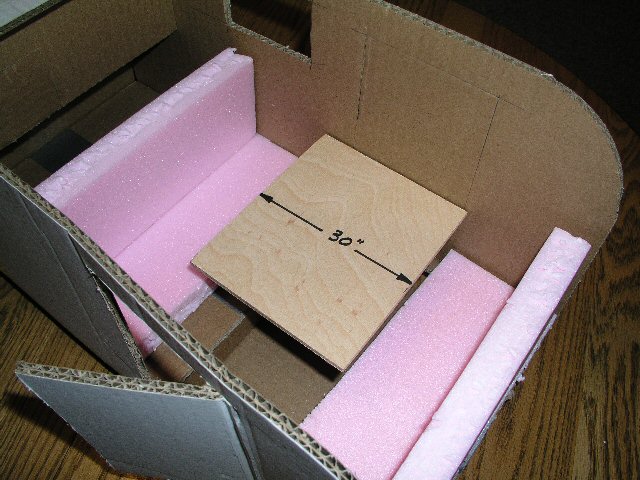

In the meantime, you're talking about something like this I think...
My first thought is there is not enough room for a table. A table should be about 30" across, which only leaves 15" for each seat. That's kinda tight. The seats should be about 21" or 22" to really be comfortable.
Postby Shrug53 » Fri Jun 18, 2004 6:04 pm
Hmm, you are probably right. I could have the bench in an L shape rather than a U. That would leave plenty of room for a table, then I could put the lip for it one on of the side walls. There will only be two of us, so that should work out fine.
You are measuring for a 48" wide trailer base, and I am actually talking about 66", however the idea is still valid. It would be a narrow table. The L shape bench would fix that.
Good catch!

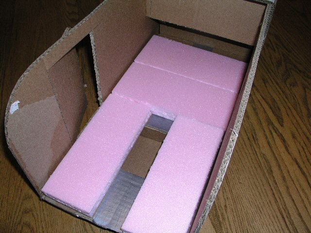

I'm not sure that L shape will work... see what I mean...
The layout I have in my Baja Benroy might work better in your design too!
Postby Nick Taylor » Fri Jun 18, 2004 7:05 pm
The last one is probably the best.
Now if that thing doesn't qualify as a tiny travel trailer I don't know what does!
Nothing like a model to help you visualize.

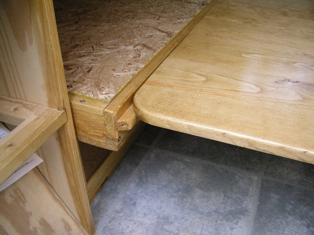

Postby mikeschn » Fri Jun 18, 2004 7:34 pm
Thats exactly right. I set it on a lip. Check out my table on the lip in this photo...

Postby Shrug53 » Fri Jun 18, 2004 7:39 pm
AHA! I guessed right. I would need to make that one strong lip! My wife and I combined are at nearly 600#
