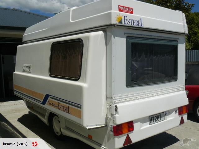

Postby mezmo » Thu Sep 09, 2010 9:47 pm
Hi cappy208.
'Came across your post and it reminded me of an Esterel that
I saw on the New Zealand auction web site TradeMe earlier in
the year. 'Thought it might have ideas for you.
Here's a 1997 Esterel [An European [French?] folding RV] side view of
the fold up/out wall containing the extra width:

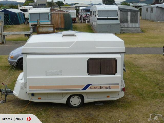

Here's a 3/4 view from the left rear. Note the extra width wall is hinged
so that internally it provides part of the front and rear dinette seats:
