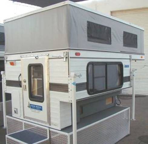

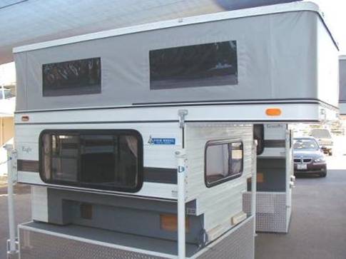

Hello,
I've been using a Four-Wheel Pop-Up camper for the last 10 years. Now that I have two kids, we've outgrown the camper. I need room for four. I would like to keep the camper and convert it into a TTT. The camper has an aluminum upper frame, and it's 6 ft. wide by 10 ft. long. I realize that I would need to cut the front end of the aluminum frame off in order to extend the interior the full length. My general design concept would be similar to George Teague's Pop Up camper.
I have been looking through this sight for many months and I am amazed at all of the innovative design and construction techniques. I'm hoping to tap into some of that expertise, knowledge and ingenuity for this project. Any ideas or suggestions would be greatly appreciated. Pictures of the original camper are posted below. Thanks.
Image[/img]

Wow, that is a great idea. I'd only use the top portion and reverse it, having the raised bed at the rear with the galley built under it. Having a low profile trailer yet being able to stand inside would be great.
Other option might to build under the cabover portion as a seperate "bedroom" from the rest of the unit and then just redo the siding to make it look like one unit. You would have tons of storage room on the lower enclosed sides.

DougH has some good ideas, either of which might work.
I would do the least amount of tear-down possible. To keep your back door and kitchen as they are, I think I would simply add on under the cab-over section and put bunk beds in that area. To blend it in, you could make the add-on portion a design feature by using a different color skin there and trimming it out. Add some of the new color in a few of the other areas, to pull it all together. Of course, this is just a guess at what you can do as I could only find the over-all camper measurements and not for that particular area.
