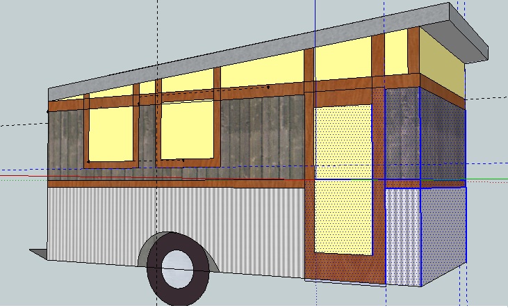

aratman wrote:Out side of the fact that the tire is just to show a tire what do you think of this?
aratman wrote:that is exactly where the basics of this idea came from, but I am going to try and finish it so it looks like a mid century modern home .
StandUpGuy wrote:I believe he is refering to using single square hinges as opposed to a continuous hinge or piano hinge.
My concern is that even when building in a lightweight manor, such a giant top as this will still be quite heavy. In addition with a completly open roof as proposed there is definitely a greatly reduced structural integrity. It is no longer a box in this idea and will be prone to much greater stresses.
