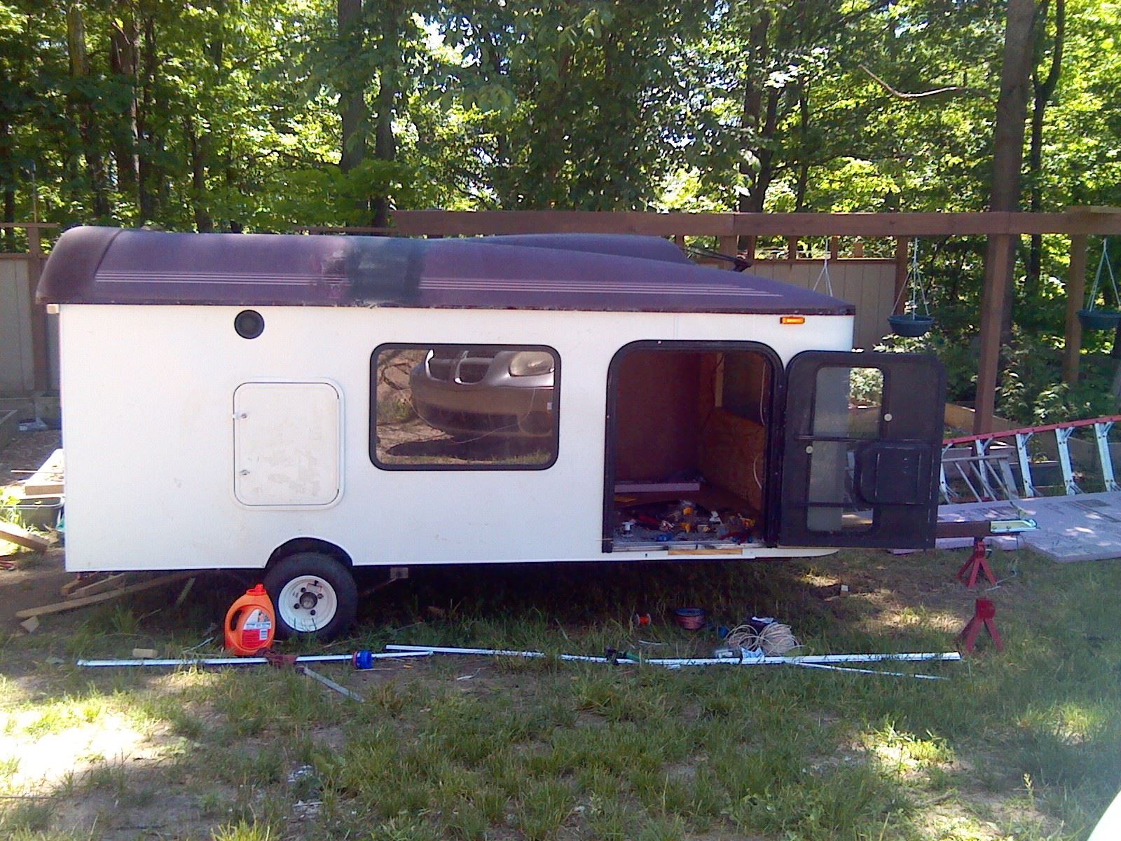

I picked up a top from a chevy and am building my trailer around it. so far so good, hope to eliminate leaking roof syndrome.

The tops are tarred, caulked and screwed on to the van top. Took me an hour with a drywall saw to cut thru the adhesives and caulk, then it took me 1/2 a day to get the remainder off of the fiberglass shell so I could size my trailer

Postby Sidekick » Tue May 29, 2018 9:22 pm
it was a worthwhile project

Postby Sidekick » Tue May 29, 2018 9:24 pm
Painted and road worthy

Postby Ottsville » Wed May 30, 2018 6:46 am
How heavy was the top and what were your final dimensions Sidekick? I've been toying with some similar ideas.

Postby Sidekick » Fri Jun 01, 2018 10:07 am
I shortened the top from 11 ft to 9'6" it was 63 inches wide

Postby Sidekick » Fri Jun 01, 2018 10:13 am
My complaint with normal campers is that they develop leaks. So by using a fiberglass top with a 2 inch overhang it is very hard for water to enter the trailer and it gives rigidity to the trailer. My latest trailer is 11'6" and will be painted to match my family SUV with the same accents - satin black trim. I plan on doing body work to the car due to rust spots and scratches , so I will paint the trailer when I do the finish work on the car.
