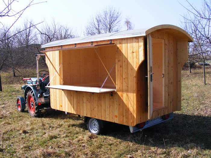

Ok so I have been totally obsessed since the idea hit me to build my own travel trailer. Then I found this website and I can't get a good night's sleep all I do is think about it. Anyway, I have gone through several different designs on paper and in my head. I wanted to build the wanderer, but then I stumbled upon the shepherders wagon from a link I found on tnttt. http://www.schaeferwagen.de/oldtimer.html
Anyway, my question is how do I build the bowed roof like that. :thinking: (ie what is the easiest way) I need the inside to have maximum headroom as it will be a standie. The interior roofline will match the exterior in shape.

That's good information. I thought about just making support arches on the two end walls and one in the middle from 3/4 inch oak plywood. Do you think that will work? It would save me from making a jig and bending wood.

I think the jig and thin strips of wood is the best way to go with the roof bows. This would make the strongest bows possible. The are actually fairly easy to construct. Use slow setting epoxy and thin strips of wood. Glue all the strips together then place on the bending jig. Clamp in place and let it dry completely before removing from the jig.

So much depends on the ultimate strength of what you desire, You could cut the center arch of plywood, & might work fine with parallel stringers between the end walls and center arch. So much variables involved to this decision.. If your overall length is not too great and you have no desire to walk about on the roof, Possibly one arch & no stringers and it might work fine.
In my case its nearly 14' length and I needed the strength to walk about on the roof without concern too much over my exact foot placement.
As well I thought the interior would appear nicer if it were built with multiple arches verses one heavy center arch and parallel stringers.

I just realized I never thanked everyone for the great ideas. I am planning on just going ahead with the arches on the ends since its only eight feet, and after if it seems flimsy I'll add a center arch. Paleo tool did it this way and it seemed good. We'll see. Thanks again
