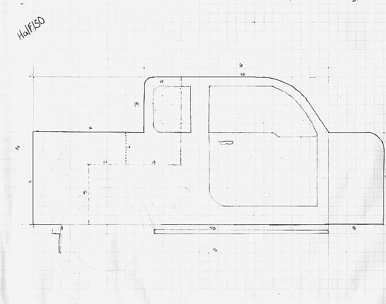

Postby dacrazyrn » Mon Oct 10, 2005 10:20 pm
After deciding that I HAD to have a tear...this is the first draing I came up with. Based on a 4x8 frame size.
It is exactly a half size 2004 Ford F-150 (measured off of mine). I really wanted to do this, but figured that it would be a bit involved for my first ever Tear.
What'cha think?

Postby mikeschn » Tue Oct 11, 2005 3:22 pm
Andrews need to paste one of his manequinns in there... it's pretty tight the way you have it drawn. Not to say anything about the wicked curves that you are going to have to bend plywood around... :?
Postby dacrazyrn » Tue Oct 11, 2005 8:20 pm
Thr front "nose" section is an 18in storage area. the cabin area is 78in (with 30 inches that is under the cabinets-feet/leg area when lying down).
Each square is a 3in x 3in.
Two of those curves are REAL tight, but only drew it to look like the truck. Definitely would have to figure out something else.
I did however bend a 2ft x 8ft 5.2 Moisture Resistant Luan around 2 12in radiuses on the BullNose. Lots of aggravation there. :D
