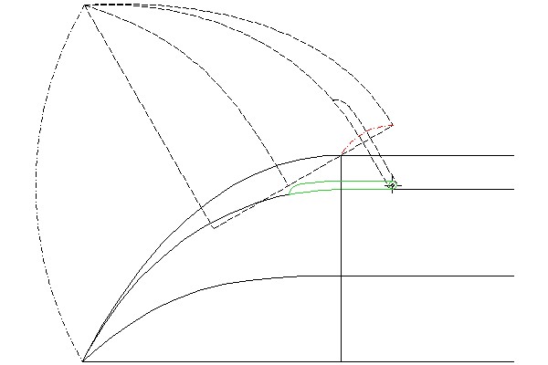

Roly, another way to hinge a shape like this is to move the hinge pivot forward of the joint. In the example below, shown in side view, an external bar (coloured green) connects a part-blimp galley hatch to the hinge pivots which are 6" forward of the joint line - a laminated wooden 'bar' with some nice contrasting layers would look good and be strong enough.
Because the pivot is well forward of the joint, the 'worst' part of the hatch is right at the top, which first moves forwards and upwards at an angle of about 45 degrees, so as long as the internals are laid out to suit this (for example, only the outer shell comes right up to the joint line and the inner bulkhead is set a further inch or so back), the hatch and the body won't hit each other.
You could, of course, recess the bar into the body so it lies flush when closed, but that is getting kinda tricky.
Incidentally, the side door on Dan's looomium Roswell opens vertically (gull-wing style) using a C-shaped hinge just like the ones that Del used horizontally on his yellow Roswell and they occupty a lot of internal space when the door is closed - plus Dan confirmed that he had to add padding to them because he eventually hit his head on them. Those internal hinges make for a nice appearance when closed, but they are a right pain the rest of the time.
